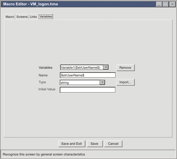

Variables tab
- Create a variable.
- Remove a variable.
- Import a Java™ class as a new variable type.
$strUserName$,
is displayed in the Variables list box. Three other fields contain
information that the macro runtime needs to create this variable:
the Name input field, the Type list box, and the Initial Value input field.The Variables list box contains
the names of all the variables that have been created for this macro.
It allows you to select a variable to edit or to remove, and it also
contains a <new variable> entry for creating new variables.
Variable1($strUserName$)The
string Variable1 is a setting that shows how many variables
you have created. It is not saved in the macro script. The real name
of the variable is $strUserName$, and you should use this
name alone throughout the macro wherever you use the variable.You have probably noticed that the variable name $strUserName$ is
enclosed in dollar signs ($). This is a requirement. You must enclose
the variable name in dollar signs ($) wherever you use it in the macro.
The Name input field displays the
name of the currently selected variable, $strUserName$.
You can change the name of the variable by typing over the old name.
Mostly you should use this field only for assigning a name to a newly
created variable. Although you can come back later at any time and
change the name of this variable (for example to $strUserFirstName$),
remember that you might have already used the variable's old name
elsewhere in the macro, in some action or descriptor. If you change
the name here in the Variables tab,
then you must also go back to every place in the macro where you have
you used the variable and change the old variable name to the new
variable name.
You can choose any variable name you like, although there are a
few restrictions on the characters you can choose (see Variable names and type names). You do not have to choose names that
begin with an abbreviated form of the data type (such as the str in
the string variable $strUserName$), as this book does.
