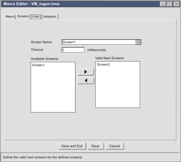

In the AME, the Links tab
provides the user interface for storing the names of candidate macro
screens into the <nextscreens> element of a macro screen. Links tab shows a sample Links tab:
Figure 1. Links tabIn Links tab, the Screen Name list box at the top of the
tab contains a list of all the macro screens in the entire macro.
The currently selected macro screen is Screen1. On the right, the Valid Next Screens list box contains a
list of candidate macro screens for Screen1. (Do not confuse this
list box, which contains the names in the <nextscreens> element
of Screen1, with the list of valid next screens that the macro runtime
uses when a macro is played back). On the left, the Available Screens list box contains a list
of the names of all other macro screens.
Links tab shows only
one screen in the Available Screens list
because this figure is from a macro with only two macro screens in
it, Screen1 and Screen2. However, imagine a macro
of twenty screens, and suppose that you want to add macro screens
to the <nextscreens> list of a new macro screen, ScreenR. You would
follow these steps:
