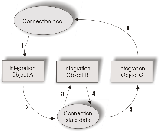

Figure 1. Connection lifetime with chaining
connection lifetime with chaining
Connection lifetime with chaining depicts the lifetime of a connection throughout the execution of three Integration Objects. Integration Object A is configured as first, Integration Object B as middle, and Integration Object C as last. Connection state data represents the connection and the state label of the last Integration Object run.
  1. When Integration Object A begins to run, it retrieves the connection specified in the macro. If checkin screen enabled and a connection is available, the connection is already logged on and ready. If checkin screen is enabled, but a connection is not available, the connection is created and the connect macro (if specified) is run. If checkin screen is disabled, a connection is created and the connect macro (if specified) is run.
  2. Integration Object A runs the associated macro, then saves the connection and its current state for the next invocation. (You would have defined this state as the stop state label during Integration Object chaining).
  3. When Integration Object B begins to run, it retrieves a connection and its state from the connection state data because it is the middle Integration Object. You must have defined Integration Object B's start state label as Integration Object A's stop state label, which allows these Integration Objects to be chained.
  4. When execution completes for Integration Object B, the connection and its state are saved in the connection state data.
  5. Integration Object C also retrieves the connection from the connection state data. When Integration Object C begins to run, it retrieves a connection and its state from the connection state data because it is the last Integration Object. You must have defined Integration Object C's start state label as Integration Object B's stop state label, which allows these Integration Objects to be chained. Last-in-chain Integration Objects have no end labels because the connection is always returned.
  6. When checkin screen is enabled, the connection returns to the pool; otherwise, the disconnect macro (if specified) is run and the connection ends.
