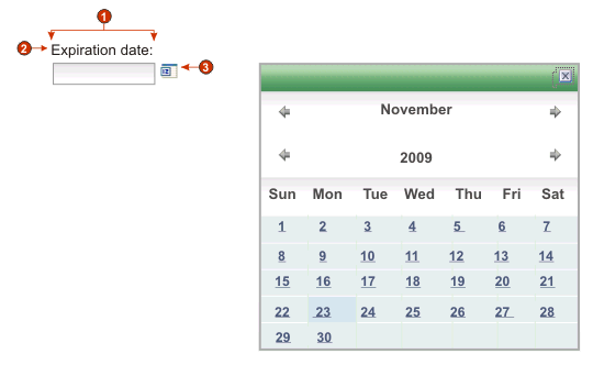

The following figure shows how the calendar widget and its date picker appear on a transformation when the Use inline calendar setting is selected:
Figure 1. Example of calendar widget with inline date picker

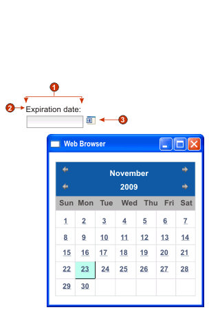

The following figure shows how the calendar widget and its date picker appear on a transformation when the Use inline calendar setting is cleared:
Figure 2. Example of calendar widget with windowed date picker
  1. Number of columns per row (1)
  2. Caption (from component)
  3. Launcher type (image)
    The examples have no captions for the launchers because the launchers are images. If the launchers are buttons or links, the launcher captions are shown on the buttons or in the links.
