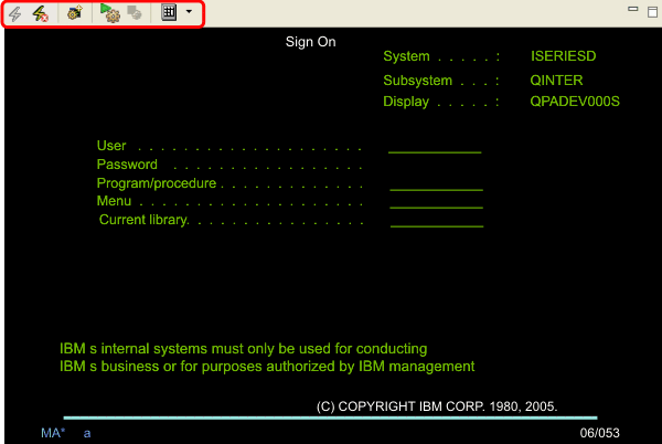

Integrated terminal
The integrated terminal toolbar allows for the following actions:
Connect
Connect to the host.
Disconnect
Disconnect from the host.
Add Screen
See Adding a screen from the integrated terminal.
Play Macro
See Playing the macro.
Stop Macro
Host keypad
Interact with the host using the host keypad pull-down.
In the integrated terminal, when navigating the host application, the F12 key is intercepted by Eclipse, which then moves the focus to the design pane of the VME. The F12 key is never sent to the host application. To work around this issue, and for other host keys as needed, use the host keypad pull-down from the toolbar.
Figure 1. Visual Macro Editor integrated terminal
