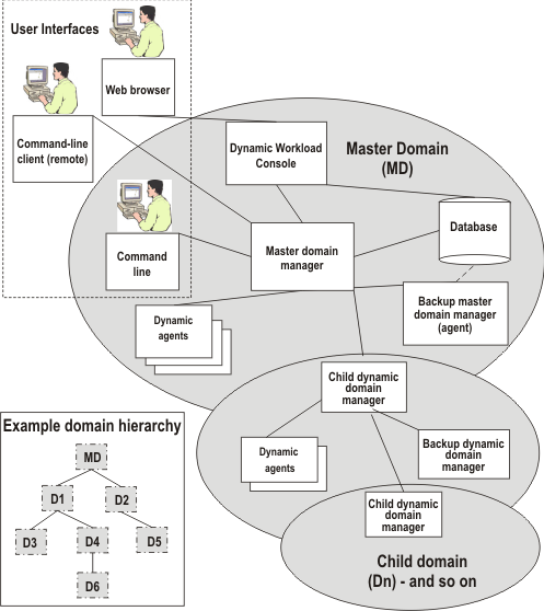

Graphical overview of HCL Workload Automation dynamic environment gives a graphical overview of a typical HCL Workload Automation environment to run dynamic workload:
Figure 2. Graphical overview of HCL Workload Automation dynamic environment
Shows a schema of a dynamic network with a master domain and 2 levels of subordinate domains, with the user interfaces. The details are described in the text that follows the image
In Graphical overview of HCL Workload Automation dynamic environment the master domain is shown with the principle components to run workload dynamically, and two levels of dynamic subdomain. The available user interfaces are also indicated. An example is provided of the basic domain hierarchical structure, where each domain is named "D1", "D2, and so on. All of these concepts are explained in the following section.
If you want to run your workload dynamically install the following components:
Master domain manager
The master domain manager is the highest level workstation of a HCL Workload Automation network. It contains or connects to the relational database that stores scheduling object definitions. It creates or updates a production file when the plan is created or extended and then distributes the file to the network. It performs all logging and reporting for the network. It can perform the role of event processing server for the event-driven workload automation feature.
Backup master domain manager
Define a backup master domain manager at installation to point to either the database being used by the master domain manager or to a mirror of that database. In this way the backup master domain manager has the latest data available to it at all times.
Dynamic Domain manager
Install this component if you need a multi-domain network and you want to manage your workload both statically that dynamically. All domains below the master domain have dynamic domain managers to manage the workstations in its domain. Each dynamic domain manager is an agent in the domain of the next higher level. To define a dynamic domain manager, install a dynamic domain manager and then perform the Configuring a dynamic domain manager procedure.
Backup dynamic domain manager
Install this component if you want a backup to your dynamic domain manager. If your dynamic domain manager experiences problems, you can switch to it with a simple procedure.
Agent
An agent is a workstation in the network that runs the jobs which are controlled by the HCL Workload Automation master domain manager.
Dynamic agent
An agent that has the following capabilities:
Run workload dynamically
It communicates with the server the status of its resources. In this way the product is able to dynamically run your workload to the best available resources by:
  • Automatically discovering scheduling environment resources.
  • Automatically following resource changes
  • Requesting additional resources when needed
  • Matching job requirements to available resources
  • Controlling and optimizing use of resources
The characteristics listed above provide high availability and load balancing potentialities to your environment and well suit virtualized environments.
When a job is submitted, either as part of a job stream in the plan or through ad hoc submission, HCL Workload Automation checks the job requirements, the available resources and the related characteristics and submits the job to the resource that best meets the requirements to run it.
Run both existing job types and job types with advanced options
It can run:
  • Existing job types. For example docommand and scripts.
  • Job types with advanced options
Manage dynamic workload broker logical resource
It can remotely run, from the agent, the dynamic workload broker resource command on the server. To manage the resource command you must also install the Java™ run time.
After installing the agent, you define its type by using Configuring a dynamic agent.
In a simple configuration, dynamic agents connect directly to the master domain manager or to the dynamic domain manager. However, in more complex network topologies, if the network configuration prevents the master domain manager or the dynamic domain manager from directly communicating with the dynamic agent, for example, if the agents are behind a firewall and need to communicate through the internet, or if they need to communicate with a Network Address Translation (NAT) process, then you can configure your dynamic agents to use a local or remote gateway. In this way, communication is concentrated in a single connection, reducing the number of connections to the master domain manager or to the dynamic domain manager. For more information about the gateway parameters specified when installing a dynamic agent, see Agent installation parameters - twsinst script.
For more information about gateway configuration, see Configuring dynamic agent communications through a gateway in the network communications information in the Administration Guide.
Extended agent
Extended agents are logical definitions (hosted by a physical workstation) used to extend job processing to selected applications (SAP R/3, PeopleSoft, and z/OS®). For information about installing an extended agent, see Scheduling Applications with HCL Workload Automation.
