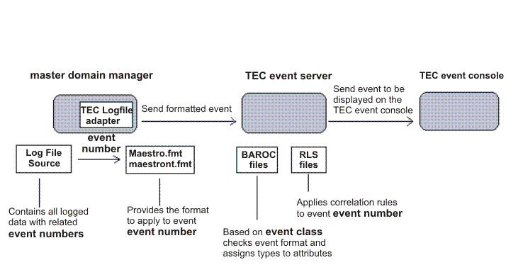

An important aspect to be considered when configuring the integration with the Tivoli Enterprise Console using event adapters is whether to monitor only the master domain manager or every HCL Workload Automation agent.
If you integrate only the master domain manager, all the events coming from the entire scheduling environment are reported because the log file on a master domain manager logs the information from the entire scheduling network. On the Tivoli Enterprise Console event server and TEC event console all events will therefore look as if they come from the master domain manager, regardless of which HCL Workload Automation agent they originate from. The workstation name, job name, and job stream name are still reported to Tivoli Enterprise Console, but as a part of the message inside the event.
If, instead, you install a Tivoli Enterprise Console logfile adapter on every HCL Workload Automation agent, this results in a duplication of events coming from the master domain manager, and from each agent. Creating and using a Tivoli Enterprise Console that detects these duplicated events, based on job_name, job_cpu, schedule_name, and schedule_cpu, and keeps just the event coming from the log file on the HCL Workload Automation agent, helps you to handle this problem. The same consideration also applies if you decide to integrate the backup master domain manager, if defined, because the log file on a backup master domain manager logs the information from the entire scheduling network. For information on creating new rules for the Tivoli Enterprise Console refer to the IBM Tivoli Enterprise Console Rule Builder's Guide. For information on how to define a backup master domain manager refer to HCL Workload Automation: Planning and Installation Guide.
- The information logged during the job scheduling process has an event number for each type of logged activity or problem.
- Each item of information marked with an event number that appears
in the EVENT field of the
BmEvents.conffile is written into the log file specified in the FILE field of theBmEvents.conffile. - The Tivoli Enterprise Console logfile adapter reads
this information inside the log file, formats it using the structure
stored in the
FMTfile (maestro.fmtfor UNIX™,maestro_nt.fmtfor Windows™) and forwards it to the TEC event server, using the TEC gateway defined on the managed node of the Tivoli® environment. - On the TEC event server, the structure of the formatted information
is checked using the information stored in the
BAROCfiles and, if correct, is accepted. Otherwise a parsing failure is prompted. - Once the event is accepted by the TEC event server, a check on
possible predefined correlation rules or automatic responses for that
event number is made using the information stored in the
RLSfiles. - If defined, the correlation rules and/or automatic responses are triggered and the event is sent to the TEC event console to be displayed on the defined Event Console.
For some error conditions on event informing that the alarm condition is ended is also stored in the log file and passed to the TEC event server via the Tivoli Enterprise Console logfile adapter. This kind of event is called a clearing event. It ends on the TEC event console any related problem events.

Default
criteria that control the correlation of events and the automatic
responses can be changed by editing the file maestro_plus.rls (in UNIX™ environments) or maestront_plus.rls (in Windows™ environments) file. These
RLS files are created during the installation of HCL Workload Automation and
compiled with the BAROC file containing the event classes for the HCL Workload Automation events
on the TEC event server when the Setup Event Server for TWS task
is run. Before modifying either of these two files, make a backup
copy of the original file and test the modified copy in your sample
test environment.
TWS_Job_Ready event class. rule: job_ready_open : (
description: 'Start a timer rule for ready',
event: _event of_class 'TWS_Job_Ready'
where [
status: outside ['CLOSED'],
schedule_name: _schedule_name,
job_cpu: _job_cpu,
job_name: _job_name
reception_action: (
set_timer(_event,600,'ready event')
).For example, by changing the value from 600 to 1200 in
the set_timer predicates of the reception_action action, and
then by recompiling and reloading the Rule Base you change from 600 to 1200 the
number of seconds the job has to be in ready state to trigger a new
message.Refer to Tivoli Enterprise Console® User's Guide and Tivoli Enterprise Console® Rule Builder's Guide for details about rules commands.
