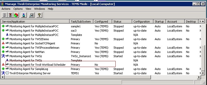

  2. The Tivoli Monitoring agent for HCL Workload Automation is listed in the Manage Tivoli® Enterprise Monitoring Services.
    The Monitoring Agent for HCL Workload Automation is listed among the Manage Tivoli Enterprise Monitoring Services
  3. Right-click the entry Monitoring Agent for HCL Workload Automation and select Configure Using Defaults. The Monitoring Agent for Windows OS: Agent Advanced Configuration window is displayed.

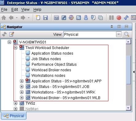

  9. Launch the Tivoli Enterprise Portal. The agent is displayed in the Navigator pane together with any agent configuration settings.
    Tivoli Enterprise Portal displays the agent in the Navigator Pane with the configuration settings
