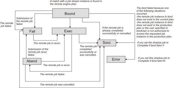

in case of failures. Shadow job
status transition chain after the bind was established shows
how the status of a distributed shadow job changes, from when a bind
is established until the shadow job status becomes SUCC or ERROR.
Only status SUCC and ERROR are considered as the final status for
a shadow job.Figure 1. Shadow job
If the remote job instance is already completed when the match
is done, the shadow job status becomes SUCC immediately.
When the shadow job status satisfies the dependency rule, the dependency
of the local job on the shadow job is resolved, and the cross dependency
for the local job on the remote job is also resolved.
