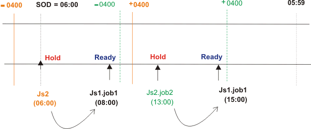

Within a relative interval
In this example, the job or job stream instance considered to resolve the dependency is the closest one in a time interval of your choice, which is defined relatively to the time when the instance that includes the dependency is scheduled to run. Job stream Js1 is scheduled to run every day at 15:00 and on Thursdays also at 08:00. Js2 is scheduled to run every day at 13:00 and on Thursdays also at 06:00, because no specific time is defined in the run cycle, it is scheduled at start of day time. Js2 uses the relative interval criteria (-04:00 to +04:00) to determine which instance is used to solve the dependency. The interval is based on the time the job stream enters the plan. The job streams are defined as follows:
SCHEDULE MY_MASTER#JS1
ON RUNCYCLE RULE1 "FREQ=WEEKLY;BYDAY=TH"
(AT 0800)
ON RUNCYCLE RULE2 "FREQ=DAILY"
(AT 1500)
MY_MASTER#JOB1
END
SCHEDULE MY_MASTER#JS2
ON RUNCYCLE RULE3 "FREQ=WEEKLY;BYDAY=TH"
ON RUNCYCLE RULE2 "FREQ=DAILY;"
(AT 1300)
FOLLOWS MY_MASTER#JS1.@
RELATIVE FROM -0400 TO 0400
MY_MASTER#JOB2
AT 1300
END
At plan creation time, conman showjobs produces the following output:
%sj @#@
                                               (Est)  (Est)
CPU      Schedule SchedTime  Job      State Pr Start  Elapse RetCode Deps
MY_MASTER#JS1      0800 11/13 ******** READY 10       (00:06)
                             JOB1     HOLD  10       (00:06)
MY_MASTER#JS1      1500 11/13 ******** READY 10       (00:06)
MY_MASTER#JS2      0600 11/13 ******** HOLD  10              JS1(0800 11/13/09).@
                             JOB2     HOLD  10(13:00)
MY_MASTER#JS2      1300 11/13 ******** HOLD  10(13:00)       JS1(1500 11/13/09).@
                             JOB2     HOLD  10(13:00)
Relative Interval matching criteria - at start of day on Thursday shows the status of the job streams in the plan at start of day on Thursday.
Figure 14. Relative Interval matching criteria - at start of day on Thursday
The figure displays the job streams at start of day on Thursday.
The instance of Js2 scheduled at 06:00 has a dependency on Js1.job1 which is scheduled at 08:00, within the relative interval based on the scheduled time (06:00). Js2.job2 depends on the instance of Js1.job1 within the relative interval based on the scheduled time (13:00). When the instance of Js1.job1 starts at 08:00, the status ofJs2 changes to Ready. From this point onwards, the sequence in which the job streams and jobs run follows the typical process.
