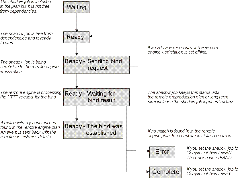

Shadow job status transition chain while establishing the bind summarizes how the shadow job status changes until the bind is established. The bind status of the shadow job is represented as STATUS - Extended status. You can see the extended status of a job shown in the SELECTING APPLICATION OCCURRENCE AND OPERATION INFORMATION panel.
Figure 1. Shadow job status transition chain while establishing the bind
The graphic shows the shadow job status transition chain while establishing the bind
The initial status of the shadow job is WAITING (W). It changes to READY (R) as soon as the shadow job becomes free from dependencies and is ready to start.
The scheduler then sends an HTTP request to the remote engine asking to bind that shadow job instance with the instance of the remote job that meets the specified matching criteria. The HTTP request contains both the information to identify the shadow job in the current plan and the information to uniquely identify the remote job instance in the remote engine plan. The scheduler requires, as well, to be notified about the status of the remote job instance bound.
