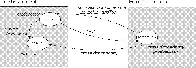

Cross dependency logic shows the logical flow implementing cross dependencies:
  1. In the bind process, the shadow job is associated to the remote job instance.
  2. After the bind is established, the shadow job status is updated according to the remote job status transition.
  3. When the shadow job status becomes COMPLETE (C) the normal dependency of the local job is released, and so also the cross dependency of that local job on the remote job is also released.
Figure 1. Cross dependency logic
The graphic shows the logic applied to cross dependency
