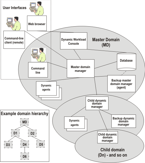

Graphical overview of a typical HCL Workload Automation environment gives a graphical overview of a typical HCL Workload Automation environment:
Figure 1. Graphical overview of a typical HCL Workload Automation environment
Shows a schema of a typical network with a master domain and 2 levels of subordinate domains, with the user interfaces. The details are described in the text that follows the image
In Graphical overview of a typical HCL Workload Automation environment the master domain is shown with the main components to run your workload, and two levels of subdomain. The available user interfaces are also indicated. An example is provided of the basic domain hierarchical structure, where each domain is named "D1", "D2, and so on. All of these concepts are explained in the following section.
HCL Workload Automation features the following components:
Master domain manager
The master domain manager is the highest level workstation of an HCL Workload Automation network. It contains or connects to the relational database that stores scheduling object definitions. It creates or updates a production plan when the plan is created or extended and then distributes the plan to the network. It performs all logging and reporting for the network. It can perform the role of event processing server for the event-driven workload automation feature.
