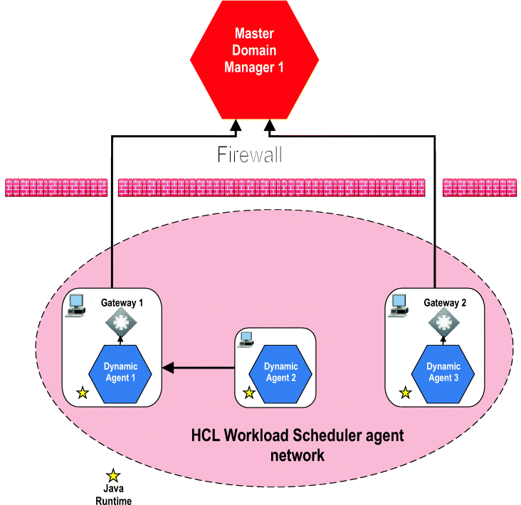

The following diagram depicts a network topology where the master domain manager communicates to the dynamic agents, located behind a firewall, through a gateway configured on one of the dynamic agents.
Network topology showing three dynamic agents: Dynamic agent 1, 2, and 3 behind a firewall, where Dynamic agent 1 and 3 communicate with the master domain manager through a local gateway, and Dynamic agent 2 communicates through the remote gateway on Dynamic agent 1.
The following are the configuration settings used in the network topology depicted in the figure:
Table 1. Configuration settings
Dynamic Agent Configuration File Parameter Value
Dynamic Agent 1 - Local gateway JobManager.ini
Section
[ResourceAdvisorAgent]
ResourceAdvisorUrl
https://
$(tdwb_server):
$(tdwb_port)/ita/
JobManagerGW/
JobManagerRESTWeb/
JobScheduler/resource
where,
$(tdwb_server)
The host name of the Dynamic Agent 1 workstation.
$(tdwb_port)
The port number of the Dynamic Agent 1 workstation.
Dynamic Agent 2 - Remote gateway JobManager.ini
Section
ResourceAdvisorUrl
https://
$(tdwb_server):
$(tdwb_port)/ita/
JobManagerGW/
JobManagerRESTWeb/
where,
$(tdwb_server)
$(tdwb_port)
Dynamic Agent 3 - Local gateway JobManager.ini
Section
ResourceAdvisorUrl
https://
$(tdwb_server):
$(tdwb_port)/ita/
JobManagerGW/
JobManagerRESTWeb/
where,
$(tdwb_server)
The host name of the Dynamic Agent 3 workstation.
$(tdwb_port)
The port number of the Dynamic Agent 3 workstation.
