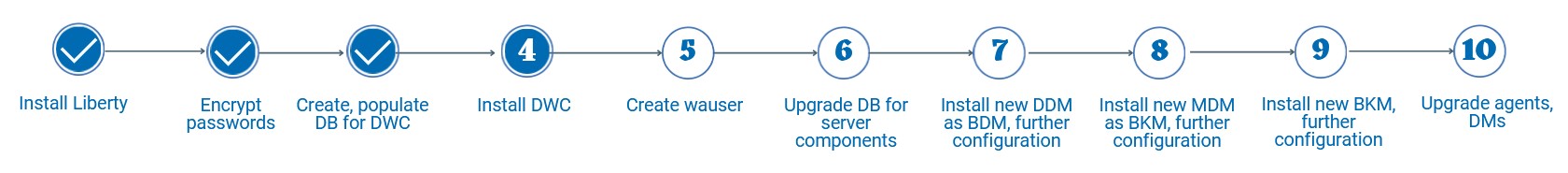

Procedure for installing two Dynamic Workload Console servers on two separate nodes.
Figure 1. Install fresh Dynamic Workload Console
The procedure to perform a fresh installation is demonstrated through a typical scenario where two Dynamic Workload Console servers are installed on separate workstations, sharing the same remote database.
From Version 9.5, the Dynamic Workload Console is based on a new architectural foundation that does not include Jazz for Service Management nor Dashboard Application Services Hub, therefore no direct upgrade procedure is supported, but you perform a fresh installation of the Dynamic Workload Console at version 9.5.x or 10.1.x to 10.2.x.
