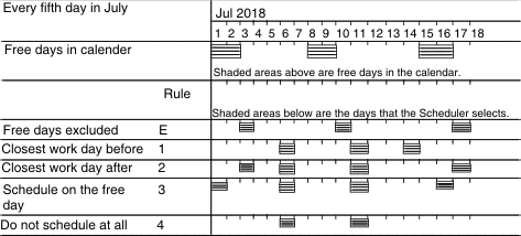

The free-day rule provides the flexibility to schedule your applications precisely when they are required. Sometimes you will find that you must work out on paper which free-day rule you should select. When you do this, consider what would happen if a normal work day is declared a holiday and, therefore, is specified in the calendar as a free day.
When an application is normally due to run but the calendar definition identifies the day as free, the free-day rule in the run cycle for that application determines the effect.
The effect of the free-day rule shows what happens for each free-day rule if you specify July with offsets 1, 6, 11, 16, and so on, or the equivalent rule, every fifth day in July.
