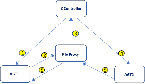

A user scenario
- Name of the File Transfer job (in this example,
MYFILE) - Agent submitting the file transfer request (in this example,
AGT1) - Destination agent where to transfer the file (in this example,
AGT2)
MYFILE, its job definition is stored in the
Z controller
JOBLIB. On the Z controller, you define the operation related to the job MYFILE.
The occurrence is then added to the current plan and submitted as required.
- Arrow 1
- The Z controller
schedules the job
MYFILEonAGT1. - Arrows 2 and 3
AGT1sends a command request toAGT2and asks for command verification to the Z controller through the File Proxy.- Arrow 4
- The Z controller
authorizes the command request towards
AGT2. - Arrow 5
AGT2sends the command data toAGT1through the File Proxy. Communication between the agents is always performed through the proxy.
