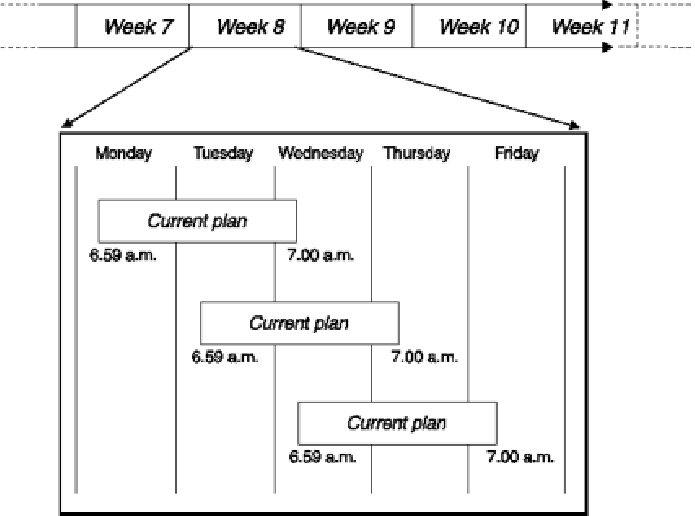

Extending the current plan shows a 48-hour current plan. The initial current plan extended 48 hours into the future: every morning the current plan is extended by a further 24 hours.
Input is taken from both the long-term plan and from the present current plan. The planning performed on Tuesday for Tuesday's work considers the actual situation (both completed and outstanding work) as reflected in the current plan.
Normally, you extend the current plan so that it stretches 24 hours from the end of the previous plan. If you do this every 12 hours, the current plan always extends at least 12 hours into the future. For instance, you could extend the plan by 24 hours at midnight and at noon. The same rules for free days and work days that apply to the creation of the current plan also apply to its extension. See Creating and extending the current plan.
