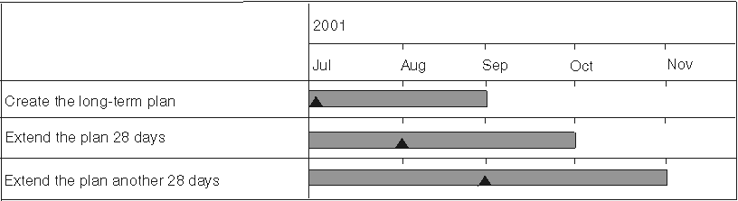

- Creates a long-term plan (LTP). This lists all occurrences of the applications that will run in a long period of typically a few months and the dependencies among them.

Strictly speaking, the current plan is created only once and the daily planning process is called extending the plan. Extension is a better term than creation, because the old current plan is also part of the new current plan. Look at the long-term plan in A rolling long-term plan.
