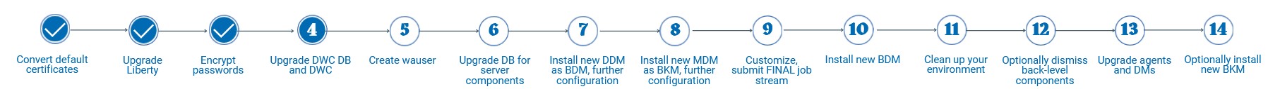

Upgrading the Dynamic Workload Console and its database
Upgrade the Dynamic Workload Console from version 9.5.0.x or 10.x to version 10.2.x. If you have several Dynamic Workload Console nodes in a cluster, upgrade all the nodes in the cluster.
When upgrading the HCL Workload Automation environment, it is a good practice to update the Dynamic Workload Console first. If you update the console, you can then use it to verify that your environment is working after updating the remaining components.
Note: If you are installing the Dynamic Workload Console version 10.2.3 or later, the Federator is also automatically installed. This component enables you to monitor your objects through the Orchestration Monitor page of the Dynamic Workload Console. For detailed information about how to configure and use the Federator, see Mirroring the z/OS current plan to enable the Orchestration Monitor.
Note: If you are using a PostgreSQL database, check the collation settings before proceeding, as described in Incorrect collation settings in PostgreSQL database.
If you are currently using Derby, you need to install a supported database and migrate your data. This is necessary because Derby is no longer supported as of version 10.2.3. For more information, see Connecting the Dynamic Workload Console to a new node or database.
