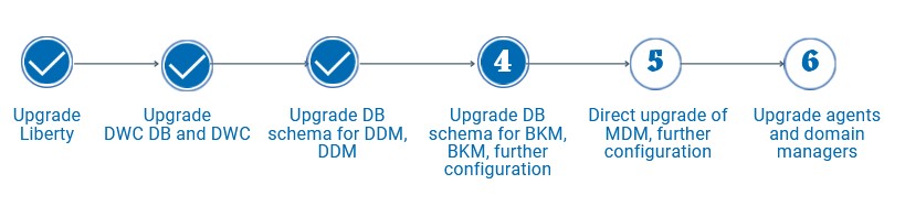

Performing a direct upgrade of the backup master domain manager and its database
Performing a direct upgrade of the backup master domain manager.
Upgrade a backup master domain manager and its database.
