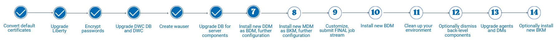

Before starting the installation, ensure the following steps have been completed:
  1. Converting default certificates. Because you are installing a dynamic domain manager, also copy locally the jwt.crt file created in the conversion procedure.
  2. Upgrading WebSphere Application Server Liberty on the workstation where you plan to install the dynamic domain manager and on the workstation where you plan to install the backup dynamic domain manager.
  3. Encrypting passwords (optional)
  4. Upgrading the Dynamic Workload Console and its database
  5. Creating the HCL Workload Automation administrative user on the workstations which will host the components at 10.2.1 level.
  6. Upgrading the database for the server components
