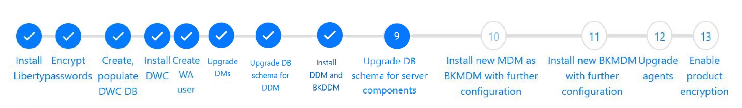

Upgrading the database schema for the server components
Upgrade the master domain manager database tables before upgrading the server components.

You have now successfully upgraded the database schema for the HCL Workload Automation database.
What to do next
You can now proceed to Installing a dynamic domain manager instance and its backup.
