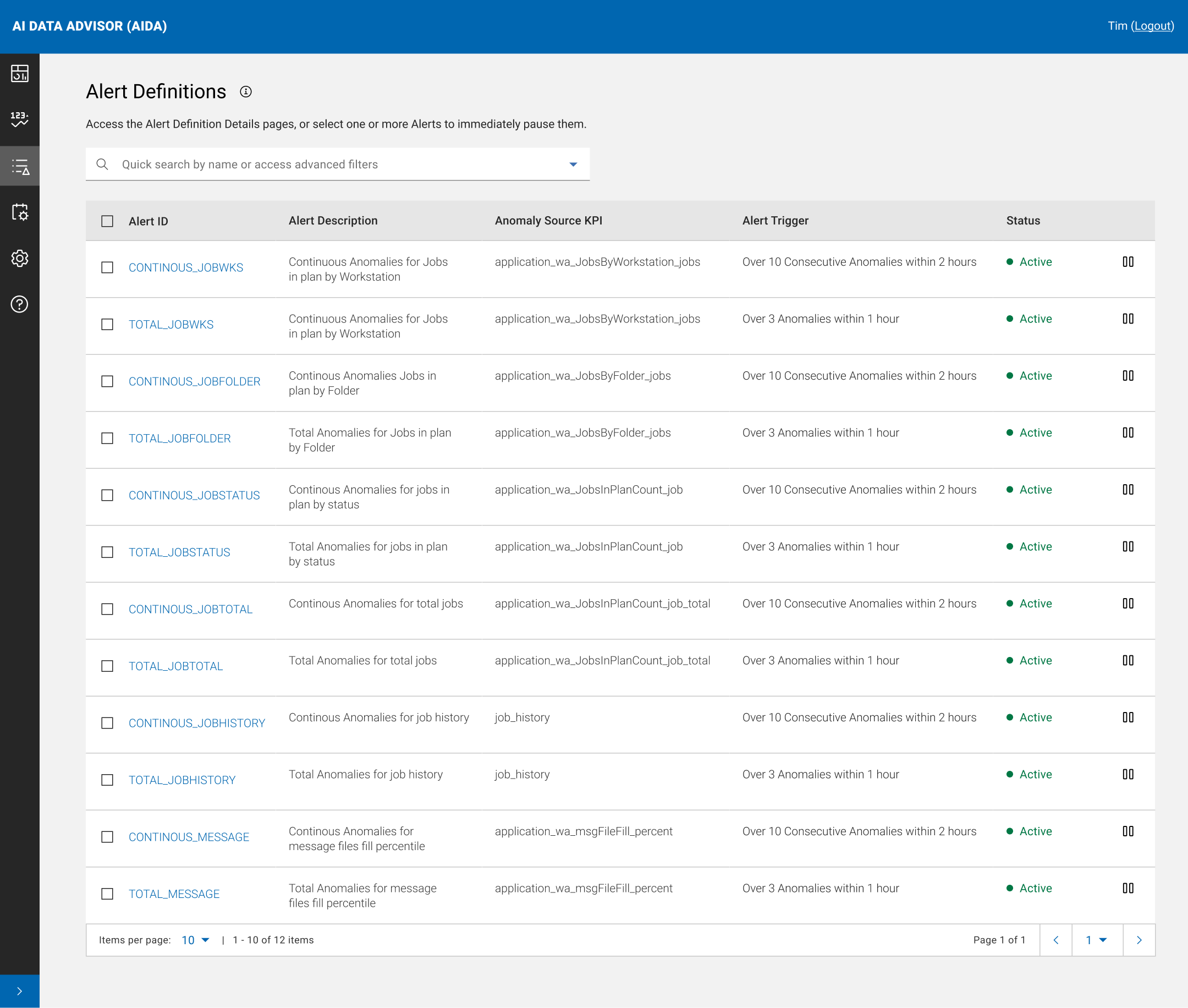

From AIDA left-hand sidebar, select Alert Definitions.
In this page you can view the full list of alert definitions in table format. The search bar allows you to search for one ore more alert definitions.
The table displays the following information:
Alert ID
The ID of the alert.
Alert Description
The description of the alert.
Anomaly Source KPI
The KPIs that contribute to generate the alert (can be more than one KPI).
Alert Trigger
Set of conditions defining the alert. For example: Over 3 anomalies within 1 hour.
Status
The status of the alert. It can be Active or Paused.
Click on an alert definition to open the Alert Definition Details where you can get detailed information about the alert, its definition and history. For details, see Alert definition details.
An action icon is available for each alert definition to Pause or Resume the alert generation. For details about pausing an alert, see Pause alert generation.
By selecting multiple alert definitions, the following bulk action icon appears in the table header:
Pause now/Resume
To pause or resume the generation of the selected alerts. Only the Pause now action is available for multiple alerts.
