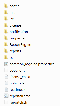

- The software needed to run these reports is contained in a package named
TWSBatchReportCliincluded in the HCL Workload Automation installation image, in the TWSBatchReportCli directory. If you plan to run them from within a scheduled job, extract the package file on one of the operating systems listed at Dynamic Workload Console Detailed System Requirements.After extracting the package, you obtain the following file structure:
