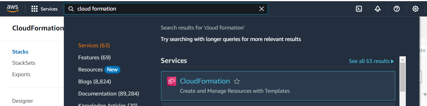

- From the AWS Web user interface, reach the AWS CloudFormation service.

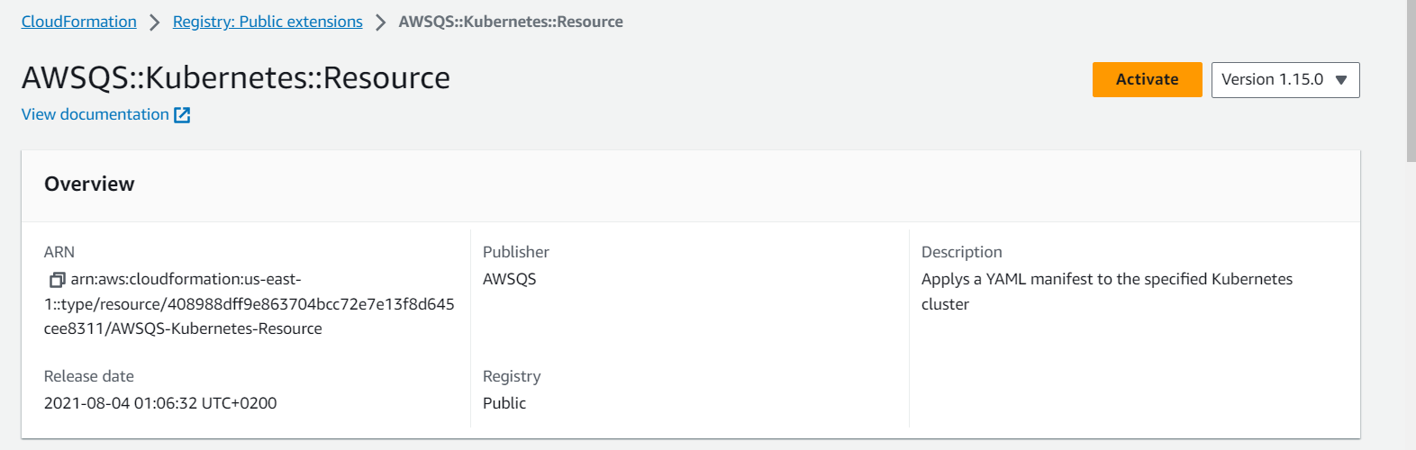

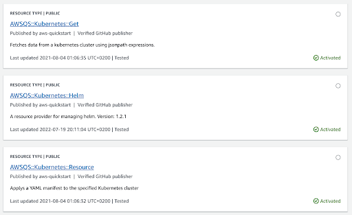

- The resources you need to active are:
- AWSQS::Kubernetes::Get
- AWSQS::Kubernetes::Resource
- AWSQS::Kubernetes::Helm

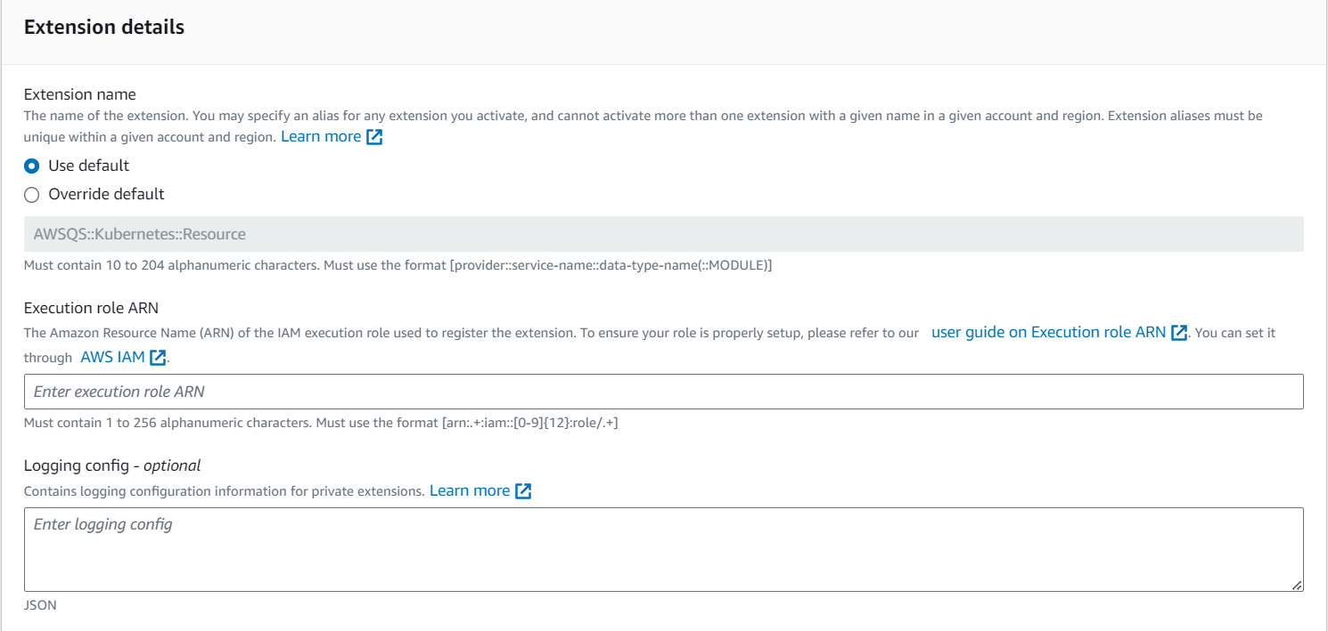

- Activate the resource
- Use the default name. Type the corresponding
Execution Role ARN created in
the previous steps. The ARN is presented in the
format
arn:aws:iam::<your_account_id>:role/role-name
- Click Activate extension
