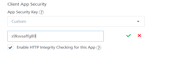

Note: You can enable HTTP Message Body Integrity by using Volt MX Foundry > Identity > SERVICE CONFIGURATION.
Usage of Custom App Security Key
Custom App Security Key that is configured in Volt MX Foundry must be provided to the SDK prior to initializing the SDK using a preshow action.

Client and server apps must be in sync with each other.
* If the Custom Security Key is enabled in Volt MX Foundry, add it in the client app.
* If the Custom Security Key is disabled in Volt MX Foundry, remove it from the client app.
The Integrity Check fails in the following scenarios:
* If the Custom Security Key is enabled on the client app and disabled on the server.
* If the Custom Security Key is enabled on the server and disabled on the client app.
* Rebuild the client application in the following scenarios of Foundry Console.
* If HTTP Integrity is toggled.
* If the app security key is toggled between App Secret and Custom.
