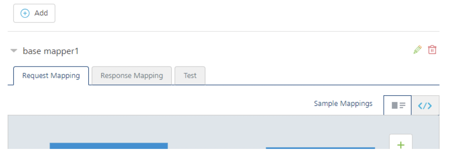

Multiple Mapper Support
From V9SP2 FP2, VoltMX Foundry support multiple mappers to an Object verb. You can create more than one Visual/XML mappings/s for a verb. During the verb creation for Objects once a verb is associated with a back-end service operation, an empty Visual/XML mapper is added by default, naming as base mapper1. The new Add button is available in the Mappings header section that allows you to create mappings. You must click this to expand it, and then click EDIT for adding mappings mapping configuration.
All the listed Visual/XML mappings/s are considered for the app, and the same will be published.
For Locked Apps: If you are using Locked Object Services, you cannot edit locked base Visual/XML mapper/s.
All locked Visual/XML mapper/s are selected with Enabled option to be included in the custom app by default.
However, you can choose to enable/disable the locked Visual/XML mappers for extending the base app functionality with or without custom Visual/XML mapper/s.
For more information, refer Locking a Foundry App
