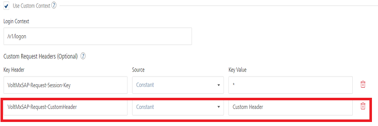

      Constant: This mode allows you to configure the custom header key and its corresponding value to be sent as a part of the backend login request.
      The value set as a part of the configuration is sent directly to SAP as a request header in the login request.

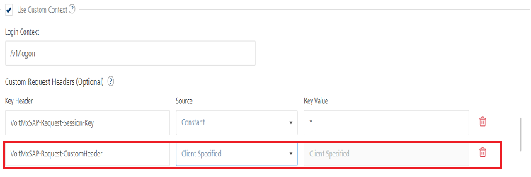

      Client Specified: In Client Specified mode, Volt Foundry picks up the value of the custom header from the client request.
      • The value field in the configuration will be disabled. When the client tries to login, the request must contain the header “VoltMXSAP-Request-CustomHeader”, else the header is not sent as a request header to SAP.
      • When there is more than one instance of the configured header in the request headers of the login request, the first value sent will be picked up.

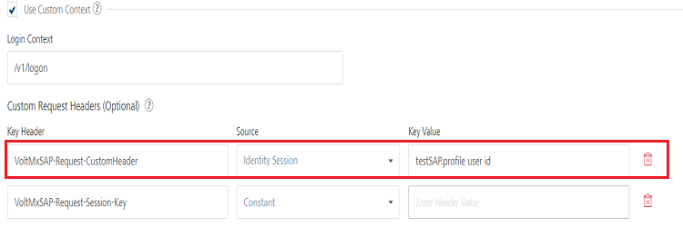

      Identity Session: In this mode, Volt Foundry picks up the value of the custom header from the identity session. The identity session contains the details of the identity providers logged into by the application. Identity session contains two different types of attributes for each provider: Profile and Security.
      For this mode to work, Volt Foundry should at least have two identity providers associated with it. The value in the provider configuration will be of the following pattern:...
      Based on the above configuration, the login request to SAP will pick up the header value from the identity session. It will pick a profile attribute named userID associated with the provider of the nametestSAP.
