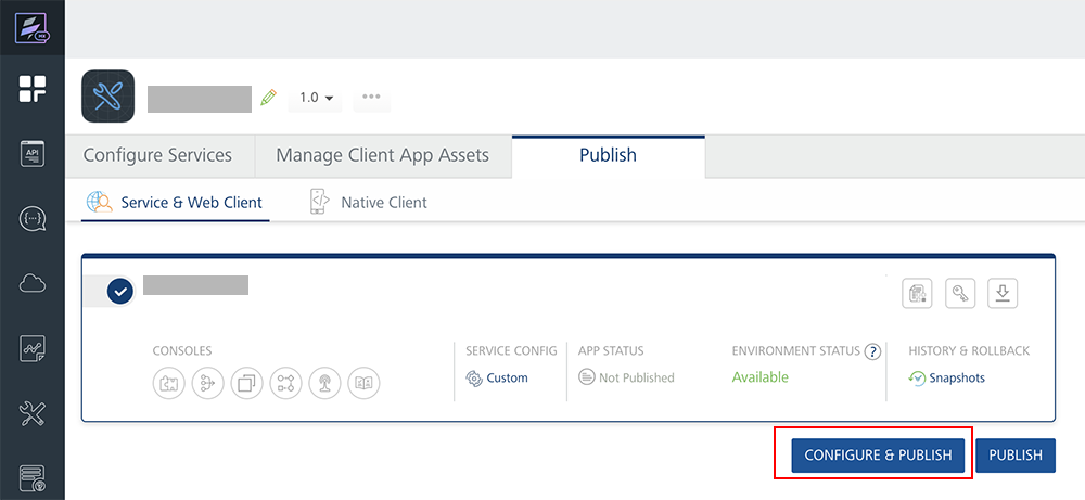

To display the app reconfiguration page while publishing an app, follow these steps:
- After you complete configuring services in an app, click the Publish tab.
- In the Publish page, select an environment. The CONFIGURE & PUBLISH and PUBLISH buttons are active only after you select an environment.
Click CONFIGURE & PUBLISH to display the app reconfiguration page.

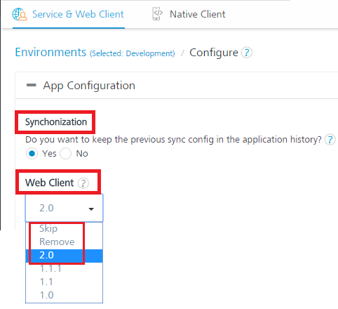

If you have configured sync services in your app and also uploaded a binary file for Web client, do the following:
Under Synchronization, choose Yes to keep the previous sync configuration in the application history. By default, the synchronization is set to No.
Note: You are publishing an update to your sync configuration. If you keep the previous sync config in the application history, any devices that already have a local copy of the data can attempt to sync only the schema changes and avoid a full sync. If you do not keep the previous sync config in application history, all devices will be required to fully rebuild their local copy of the data using a full sync. In either case, the client app must be rebuilt with the new sync configuration and updated to all devices.
Under the Web Client, Select the required version from the drop-down list. When you select a version and publish the app, the system overrides the existing version of the
.war
file with the selected new version in the Server. If there is no published version, the system adds the new Web client in the server.- Skip: If you select Skip, Web Client Assets will not be included in this Publish. If you select a version of Web Client, the last published Web Client will be deleted and the said Version of Web Client will be published to Server.
- Remove: If you select Remove, the Web Client is removed if present in the Server.
