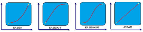

animCurve
Optional. The parameter specifies the animation curve to be applied while playing the animation. An animation curve defines the speed of the animations at different intervals of the animation duration. Following are the available options of animation curve:
  • constants.ANIMATION_CURVE_EASEIN: Specifies the animation effect to start slow in the beginning.
  • constants.ANIMATION_CURVE_EASEOUT: Specifies the animation effect to slowdown towards the end.
  • constants.ANIMATION_CURVE_EASEINOUT: Specifies the animation effect to start slow and slowdown towards the end.
  • constants.ANIMATION_CURVE_LINEAR: This is the default value. Specifies the animation effect to continue with the same speed from start to end.
