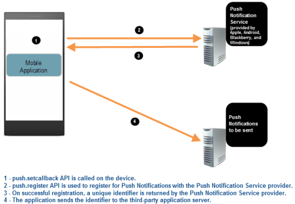

Enabling Push Notifications
To enable Push Notifications for an application do the following:
  1. The application uses the voltmx.push.setCallbacks function and specifies the functions to be executed for Push Notifications.
  2. The application uses the voltmx.push.register API to register for Push Notifications with the corresponding Push Notification Service provider of the device OS.
  3. If the registration is successful, the Push Notification Service provider returns a unique identifier to the device.
    The following is the list of Push Notification Service providers and the unique identifier they return:
Push Notifications Service Returned Unique Identifier
Android Cloud to Device Messaging (C2DM) Firebase Cloud Messaging (FCM) Registration ID
Apple Push Notification Service (APNS) DeviceToken
Microsoft Push Notification Service (MPNS) Unique URL
  1. The application sends the identifier to the third-party application server. The third-party application server can use this identifier to send Push Notifications to it.
The following image illustrates the steps involved in enabling Push Notifications for an application on a device:

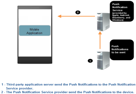

Sending Push Notifications
The following are the steps involved in a third-party application server sending Push Notifications to an application on a device:
  1. The third-party application server uses the unique identifier (sent by the application ) in sending the Push Notifications to the Push Notification Service provider of the device.
  2. The Push Notification Service provider then sends the Push Notification message to the application on the device.
The following image illustrates the steps involved in sending Push Notifications to an application on a device:
