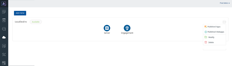

    1. Log in to Foundry Console which you upgraded for V9.x.
    2. In your Volt MX Foundry account, click Environments. The Environments page appears.
    3. Click MODIFY for the environment. The Modify Environment page appears, shown below:
    4. In the Modify Environment page, click SAVE.

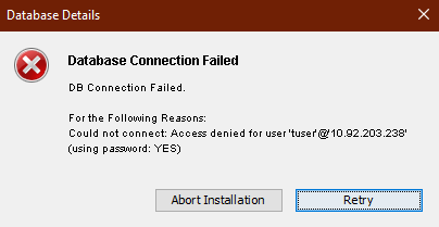

  • Issue
    After entering Database details the DB connection fails with the following error:
    Workaround
    The password used for the Database must not contain exclamation marks (!).
