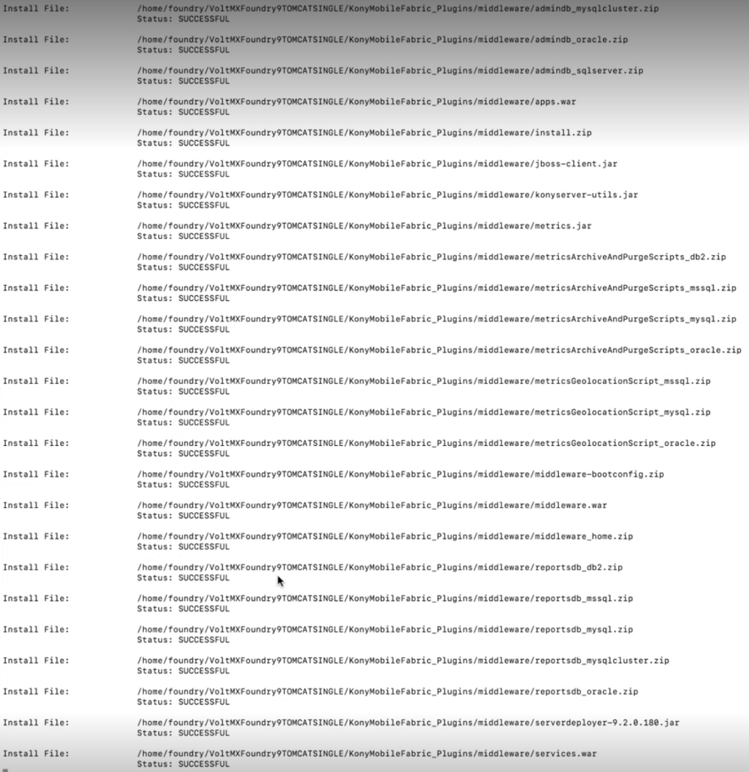

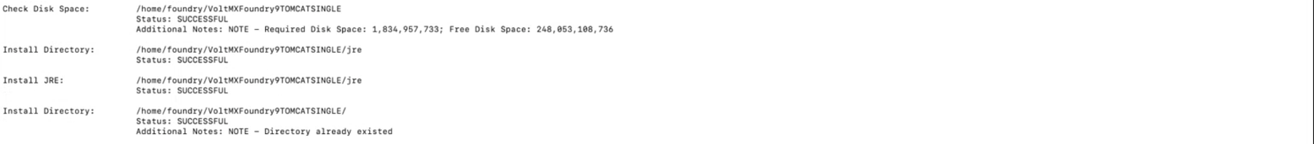

The <Install Location> directory contains the log files logging each invocation of the installer. To make problem identification easier, provide these log files to Volt MX when reporting an issue.

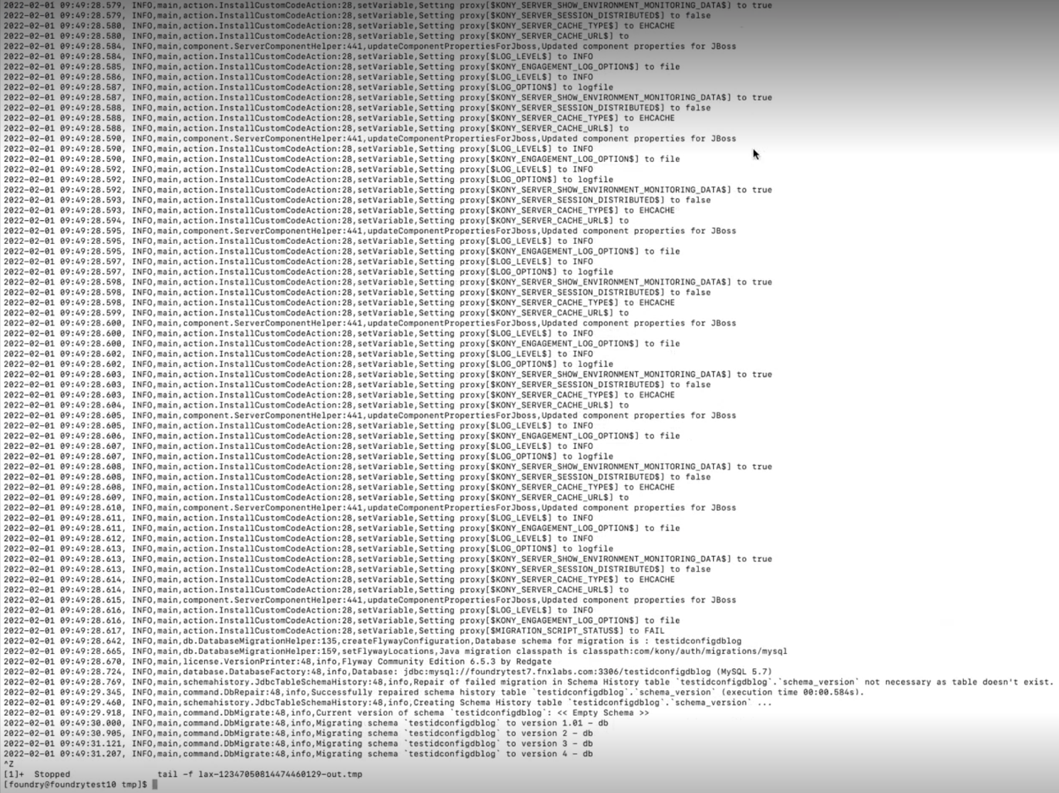

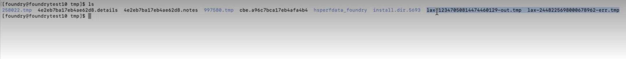

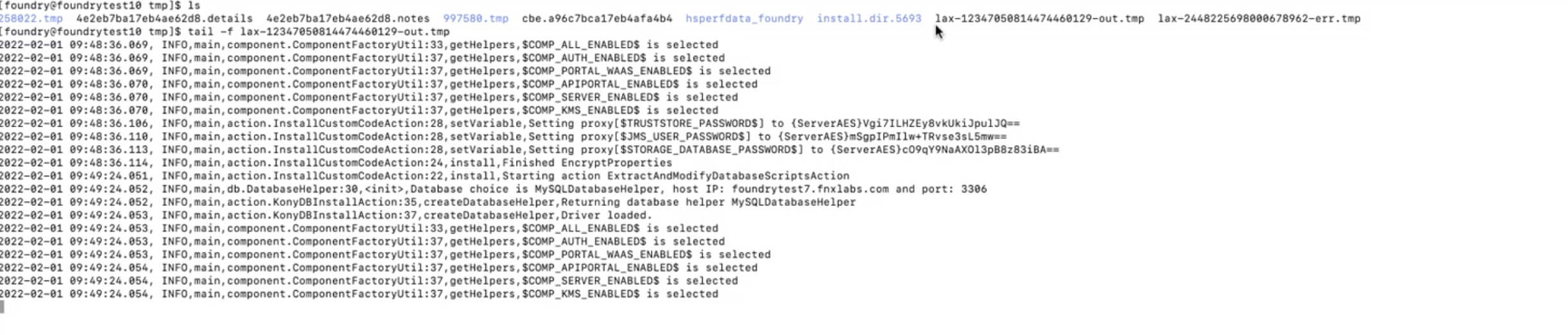

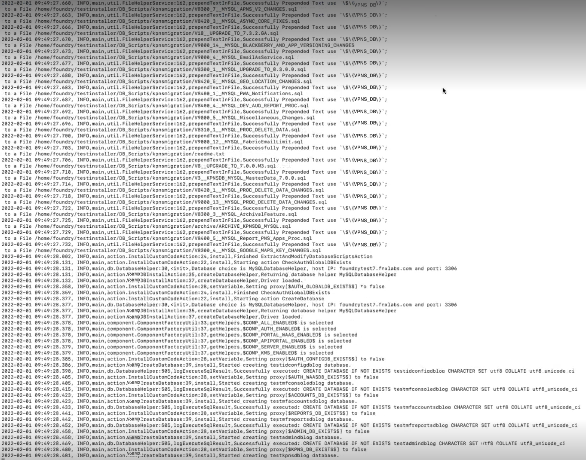

Accessing the live installation logs while the installation is running
  • Note: "tmp" directory is available inside JBoss_Home location.
  • During the installation, all the live logs will be created in the "tmp" directory, with the file name prefixed as "lax-" followed by timestamp. These are the two installation log files:
    • lax-12347050814474460129-out.tmp
    • lax-24487050814400678962-err.tmp
    installation_log_files_1
  • Note: These two files are important if there is any interruption to the installation, and due to which these files will not be merged into a single log file.
  • Tailing live log files during installation:
    To tail the live log files during installation, run the following command:
    tail -f lax-12347050814474460129-out.tmp tail_log_files_1 tail_log_files_2 tail_log_files_3

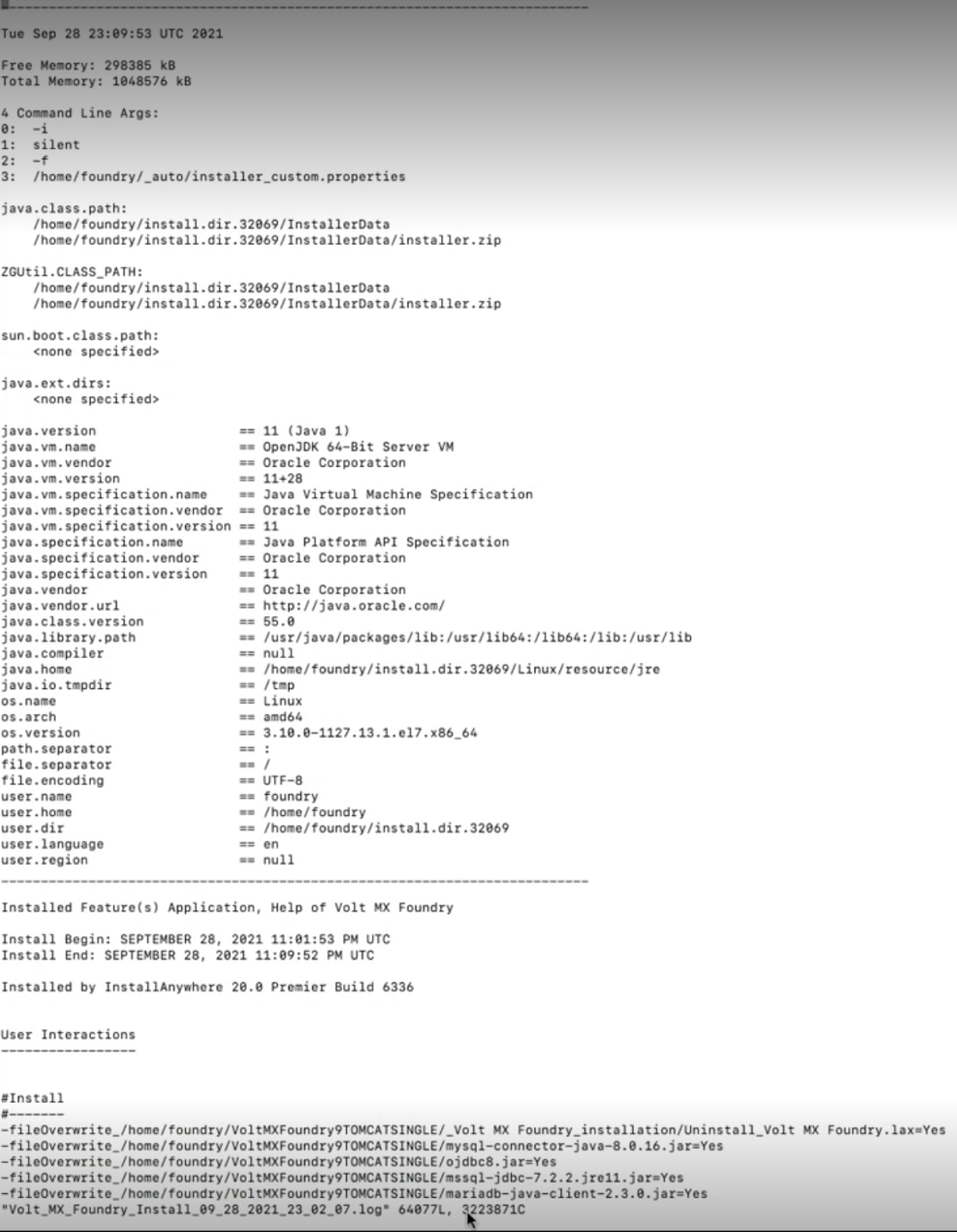

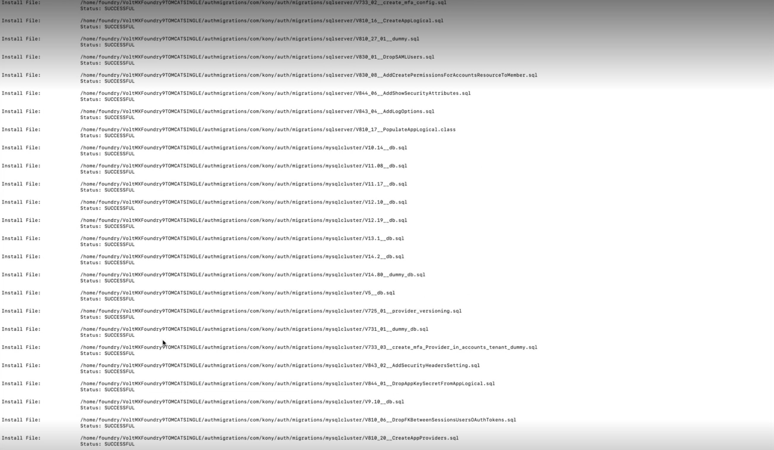

  • Once installation is done, these two log files will be merged and stored in the installation directory, with the file name prefixed as "Volt_MX_Foundry_Install_" followed by timestamp. merged_log_files_1
  • Reading log files once installation is completed:
    To read the log files once installation is completed, run the following command:
    vi Volt_MX_Foundry_Install_09_28_2021_23_02_07.log reading_log_files_1 reading_log_files_2 reading_log_files_3 reading_log_files_4 reading_log_files_5

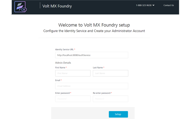

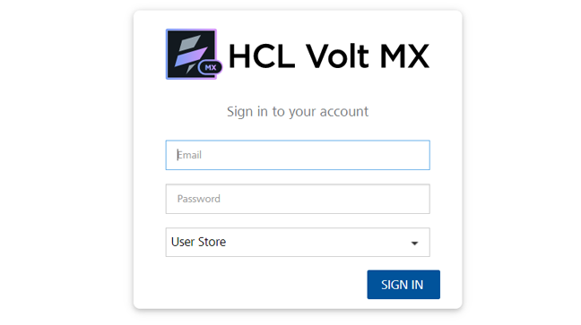

Note: You can now access Volt MX Foundry Console by using the URLs. For more details, refer to Accessing Volt MX Foundry Console - On-premises.
During installation if you have configured your super administrator account, you can directly log in to Volt MX Foundry Console by using the Console URL.
