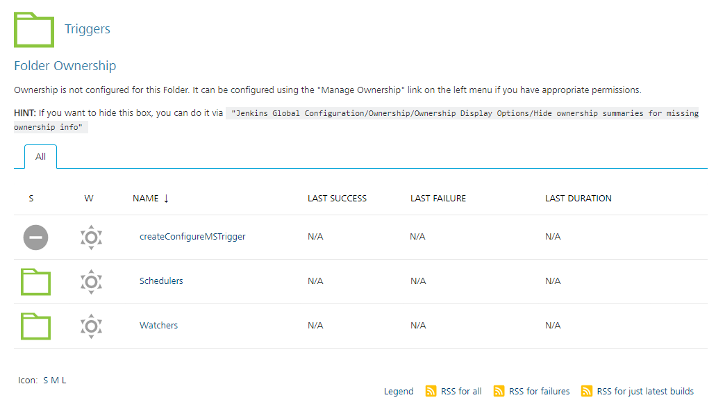

Every project contains a sub-folder called Triggers in the Microservices folder. The Triggers folder contains a job called createConfigureMSTrigger (to create triggers), and a sub-folder called watchers, which contains the jobs that build a specific branch selection when they receive a call from the webhook on the SCM system.

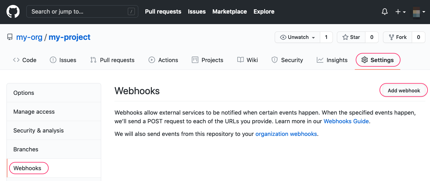

  1. Open your GitHub repository in a web browser, navigate to Settings → Webhooks, and then click Add webhook.
    The Add webhook page opens.

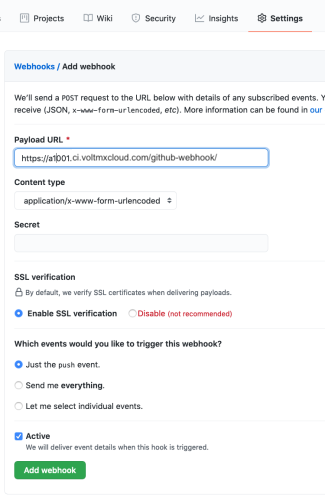

  2. Configure the following parameters in the Add webhook page:
    • Set the Payload URL to: https://<App Factory domain>/github-webhook/
      For example: https://a1001.ci.voltmxcloud.com/github-webhook/
      For more information, refer to Payload URL Format.
      The last forward slash in the Payload URL is mandatory.
    • Content type must be application/x-www-form-urlencoded
    • Jenkins verification does not require a Secret. Leave the field empty.
    • Select the Just the push event option. Only pushes of code to a specific branch trigger the ConfigureMS job.
    • The Active option should be marked by default.
  3. After you configure the necessary parameters, click Add Webhook.
    The webhook is created.
  4. You can Edit or Delete a Webhook by clicking the respective button. For more information about Webhooks, refer to the GitHub Webhook Documentation.

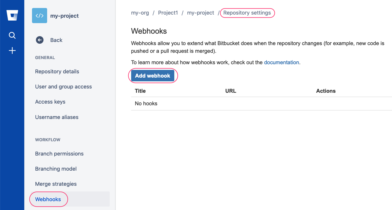

  1. Open your BitBucket repository in a web browser, navigate to Repository Settings → Webhooks, and then click Add webhook.

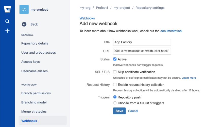

  2. On the Add new webhook page, configure the following parameters:
    • Set the title to App Factory
    • Set the URL to: https://<App Factory domain>/github-webhook/
    • Leave the status set to Active
    • Select the Triggers option for Repository push
  3. After configuring all parameters, click Save.

  1. From the Database folder of your project, navigate to Triggers.
  2. In the Triggers folder, click the build icon for the createConfigureMSTrigger job.
    Alternatively, open the drop-down menu for the createConfigureMSTrigger job, and then select Build with Parameters.
  3. For the CRON_SCHEDULE parameter, make sure that the field is blank.
  4. Configure the remaining parameters for the job, which are the same as the ConfigureMS job.
  5. After you configure the parameters, click BUILD.
Jobs that are triggered when changes are pushed to a branch are stored in the watchers folder. You can tell what branch it watches by the branch specifier expression that is appended to the job name.
