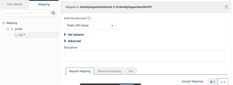

  1. Under the Objects tab in Volt MX Foundry Console, go to the Mapping tab of your object.

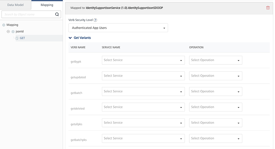

  2. Click GET. The following screen appears.
  3. Expand the Get Variants field. Map the getbatch verb to the service that downloads in batches.

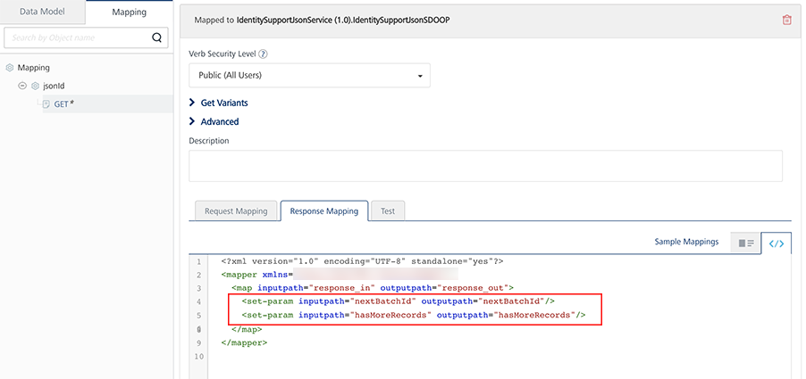

  2. Under the Objects tab in Volt MX Foundry Console, go to the Mapping tab of your object.
  3. For the corresponding object, add the following lines of code in the Response Mapping tab of the GET operation and save the changes.
    <set-param inputpath="nextBatchId" outputpath="nextBatchId"/> <set-param inputpath="hasMoreRecords" outputpath="hasMoreRecords"/>
