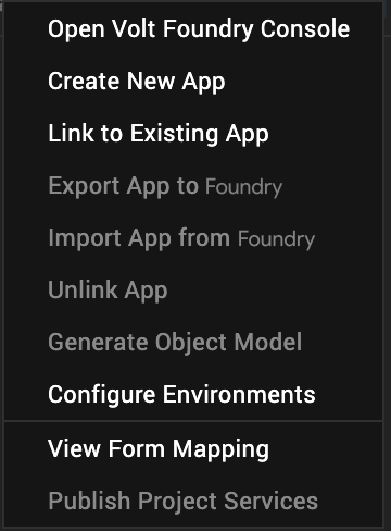

- On the upper-right corner of the screen, select Data & Services.
Click the contextual menu icon
. A list of options appears. -
Select Generate Object Model. The generated models, which represent the server app model, enable CRUD operations on the underlying Volt MX Foundry objects.
