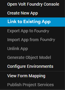

On the upper-right corner of the screen, select Data & Services. Click the contextual menu icon
to select Link to Existing App option from the list.
Select Link to Existing App. The VoltMX Foundry Applications page opens with a list of applications.
- Click Associate against the app that you want to link. The Foundry application is now linked to your Iris project.

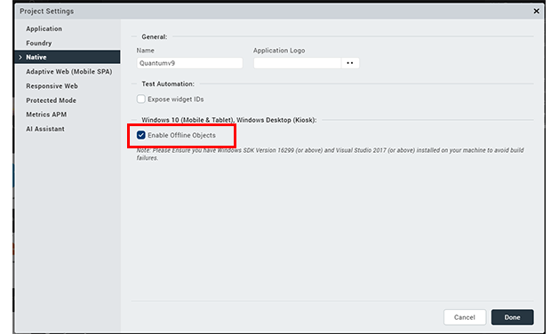

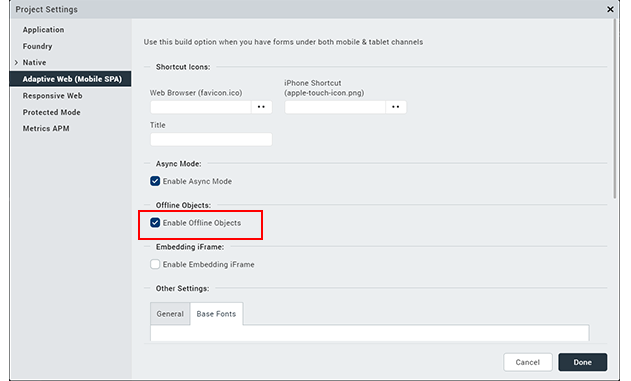

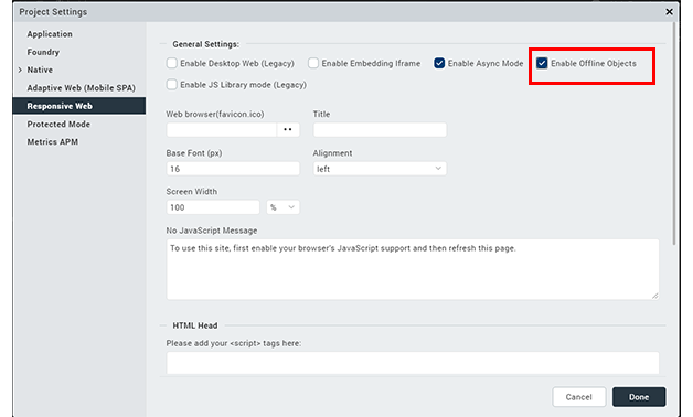

Enable the Offline Objects feature for the respective platforms. To do so, go to Project > Settings, and select the Offline Objects check box for the respective platforms.
Note: For Android and iOS platforms, the offline objects feature is enabled, by default.
Windows
Adaptive Web
Responsive Web
