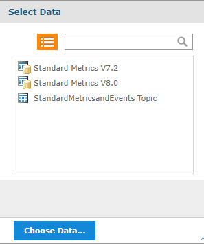

To create a custom report, follow these steps:
  1. In the Reports > Custom Reports, click CREATE REPORT.
    Note: Upon clicking Create Report button, the Standard Domain (Standard Metrics V8.0) is updated with new fields.
    The following Data Choose: Source dialog appears.
    Volt MX On-Premise Volt MX Cloud
    JasperReports Server 6.0/6.2/7.1 JasperReports Server 7.1

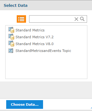

  2. Select Data.
    There are two types of datasets. Datasets starting with word Standard contains metrics collected for all applications deployed to development environments in the Cloud/VoltMX Foundry account. The Standard datasets are available even if no custom metrics have been defined.
    Standard Metrics V8.0 is the latest Standard dataset. Standard Metrics V7.2, Standard Metrics, and Standard Metrics and Events are older versions of datasets and subsets of the Standard Metrics V8.0. For Cloud/On-premises, it is recommended to use Standard Metrics V8.0 dataset.

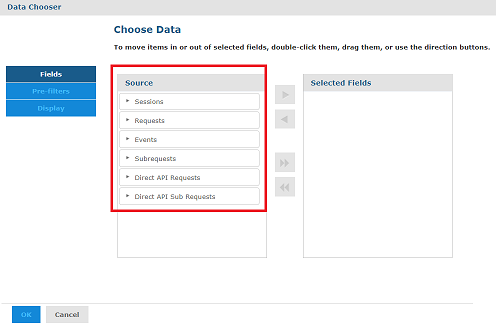

  3. Click Choose Data. The Data Chooser dialog appears.
    • For Custom Reports using Standard Metrics V8.0, the Source is classified into six sections as follows.
    • Sessions
    • Requests
    • Events
    • Subrequests
    • Direct API Requests
    • Direct API Sub Requests
    The Data Chooser for Standard Metrics V8.0 is as follows.

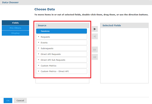

    • For Custom Reports using the Custom Metrics Domain, the Source is classified into eight sections as follows.
    • Sessions
    • Requests
    • Events
    • Subrequests
    • Custom Metrics
    • Custom Metrics - Direct API
    The Data Chooser dialog box appears as follows.

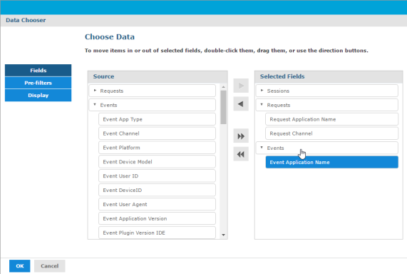

  4. Select items from the Source pane and move them to the Selected Fields pane.
    1. Click Add to move an item from Source pane to Selected Fields pane.
    2. To move all the items from Source pane to Selected Fields pane, click Add All icon.
    3. To remove the items from Selected Pane, select an item from the Selected Fields pane and click Remove icon.
    4. To move all the items from Selected Fields pane to Source pane, click Remove All icon.
      • For Custom Reports using either Standard Metrics V8.0 or Standard Metrics V7.2 or Custom Metrics Domain.
      • For Custom Reports using other datasets.
      Note: Selecting display fields in the Fields screen is a mandatory step.

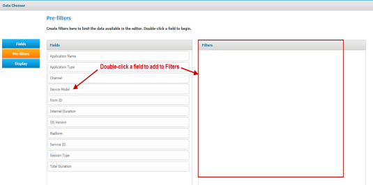

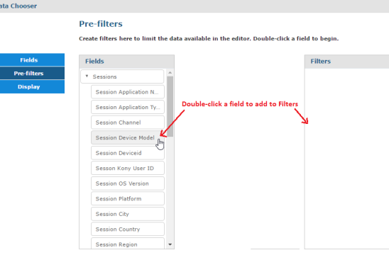

  5. Click Pre-filters. This is an optional setting if you want to restrict data available to the report builder.

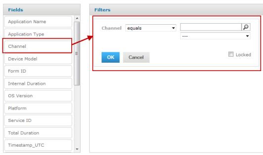

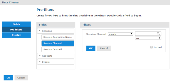

  6. To add a Pre-filter, double-click a field from Fields pane. The field is added to the Filters pane, and you can configure options to customize the filter. For example, if you want to view only the data of custom metrics services, and not view data of other service calls for the same application, create a filter for Service ID. Next, choose a function as equals, choose capturevoltmxcustommetrics from the list, and configure it.
  7. Click the Locked check box to make the pre-filter unchangeable within the report builder.
    Important: Do not use this option if you want the filter value to be editable from the report builder (Ad Hoc view).
      The following image shows a filter added to the Filters pane.

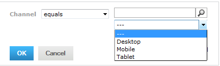

    • Select criteria from the list. By default, equals is selected. The following options are available:
    1. Search for the type by entering a keyword in the box and click Search. The type of the item is based on the selected pre-filter.
    2. You can also select the type from the list. The list is populated with all the values of the selected pre-filter. In the current example, the list is populated with all types of channels.
  8. Click OK. The filter is added to the Data Chooser. You can modify or remove the filter by clicking on Change or Remove links.

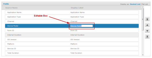

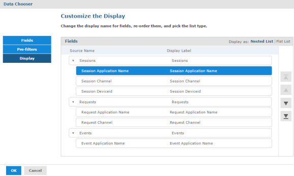

  9. Click Display. The following screen appears.
  10. For Custom Reports using Standard Metrics V8.0, Standard Metrics V7.2, or custom metrics.
    In this screen, you can change the display name for fields, re-order, and pick the list type.
  11. For Custom Reports using other datasets.
  12. Click a Display Label and an editable box appears.
  13. For Custom Reports using Standard Metrics V8.0, Standard Metrics V7.2, or custom metrics.
  14. For Custom Reports using other datasets.
  15. Enter a name for the display label.
  16. Move the fields up or down using the Move Up and Move Down options.
  17. Move multiple fields to top or bottom using the Move to Top and Move to Bottom options.

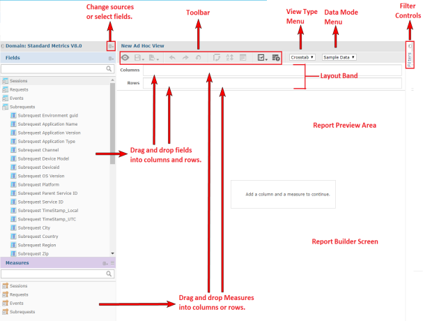

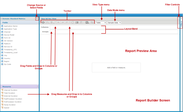

    1. Click Table to generate a table report. A report builder screen appears in which you can customize the view of the report with Fields and Measures. To view the user interface elements of a table report, click here.
    2. Click Chart to generate a chart report. There are different kinds of chart reports available in the cloud portal. To view the user interface elements of a chart report, click here.
    3. Click Crosstab to generate a cross tabulation report, which allows you to do cumulative operations such as total and sum. To view the user interface elements of a crosstab report, click here.
    4. Click Cancel to close the Data Chooser dialog.
    Note: The default data view type is Crosstab. You can change it to either Table, Chart or Crosstab after the report builder user interface gets loaded.
    The Default Ad Hoc View for Table report is illustrated in the following picture:
    • For Custom Reports using Standard Metrics V8.0, Standard Metrics V7.2, or custom metrics.
