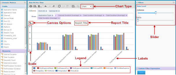

The following figure illustrates the Canvas or Report Builder area in the Ad Hoc Editor. Sliders in the Filters pane are also shown:
- Chart Type - Allows you to modify the selected chart type. As Chart is selected, the chart type of report is displayed in the Report Builder area.

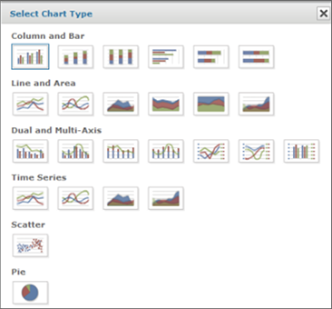

- Canvas Options - Allows you to select different chart types and chart formats.
- Click Chart Types.. option. The following dialog appears. Click to select a chart type. A blue border indicates the current selection.
- Scale - All measures are plotted against the same scale, which is sometimes confusing. You can use a calculated field to multiply or divide one measure so that its values are closer to those in the other measures in your chart.
- Legend - The legend is created when measures are added to the chart. Click one or more legends to hide the associated measures; click again to show them.
- Labels - The labels on the horizontal scale indicate the values by which the chart is grouped. If there are too many values in the chart, zoom in or use filters to reduce your data.
- Slider - Drag to set the level of aggregation to use for viewing the data.
- Report Title - This allows you to enter a report title.

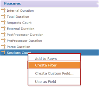

- Filter a Chart - Right-click a field in the Data Selection panel or the layout band and select Create Filter.

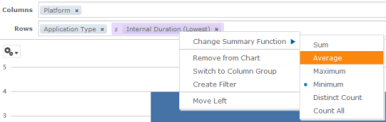

Select a measure’s summary function - Right-click the measure’s name in the layout band, and select a function from the context menu.
