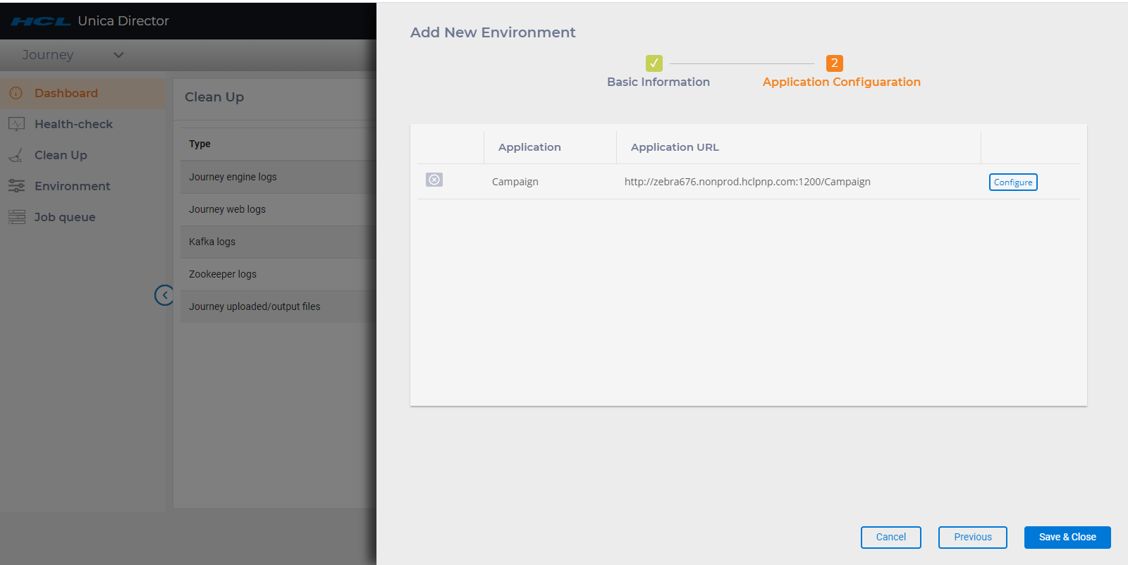

Application configuration screen
In the Application Configuration screen, all the applications that are available in the environment will be fetched and populated. (In this release, we are supporting Campaign and Journey)
In the screenshot below, the gray icon indicates that the application is not configured. If the user hovers on the icon, they can see which all components in the application are not configured.
To be able to perform various functionalities on the Unica director, at least one application should be configured.
To configure an application, click on the Configure button on the application listing page. In the above screenshot, user can configure campaign application.

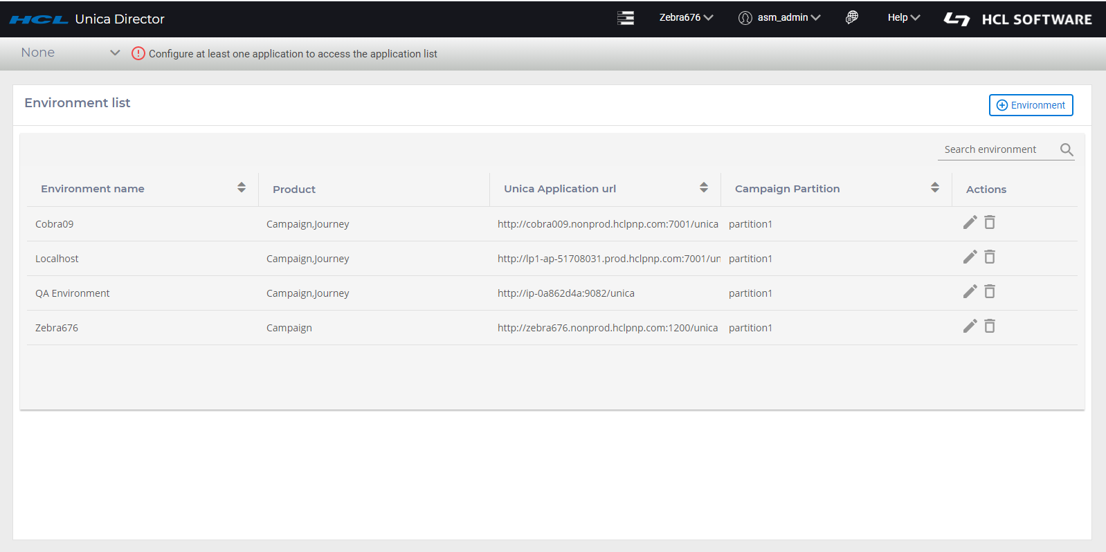

When no applications are configured
If user creates an environment, but does not configure any application, on login to that environment, they will see below screen.

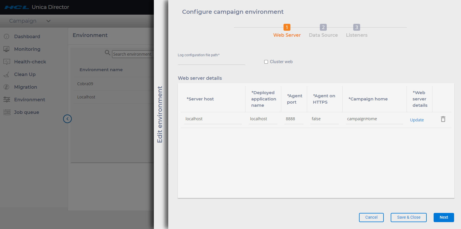

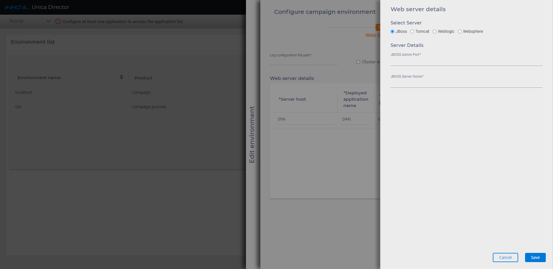

- Web Server
Clustered Web: This option specifies if this environment is a web cluster or standalone. If this option is not enabled, then you can enter only one record in the WebServer. If this option is enabled, you can add details of all the nodes in the cluster.Note: If you have already added details of all the nodes in the cluster with this option enabled and then if you disable this option, all application server entries are removed.
Application Servers - Web Servers:
User must enter below details to save the Application Server details:
- Server Host: Enter the fully qualified host name where the application server is running.
- Deployed Application Name: Enter the Unica Campaign application name –
- for Weblogic by default it is Campaign,
- for Websphere, Tomcat and JBOSS you can specify the application name given while deploying Campaign.war file. This name is used to start and stop the application from the Health Check screen.
- Agent port: Specify the Unica Director Agent port.
- Agent on HTTPS: Set this to True or False as applicable.
- Campaign home: Specify the Campaign home.
- Web Server Details: Click Update. Select the type of server, that is, Weblogic,
Websphere, Tomcat or JBoss:
ServerType - If the Server Type selected is "WebSphere"
- WebSphere Profile Path -> Specify the Application server profile location. e.g. /opt/IBM/WebSphere/AppServer/profiles/AppSrv01
- WebSphere Server Name -> Specify the Application server name where Unica Campaign application is deployed. For example - WebSphere by default has server name as "server1"
- WebSphere Node Name -> Specify the WebSphere application server node
name where the Unica Campaign application is deployed
E.g. -zebra658Node01 - You can get these details from the websphere admin console.
ServerType - If the Server Type selected is "Weblogic"
- Weblogic Console Port -> Port number used by Weblogic Console
- Server on https -> Is Weblogic Server on https
- Weblogic Server Home -> Path of Weblogic Home e.g. C:\webservers\WL12213
ServerType - If the Server Type selected is "Tomcat"
- Tomcat JMX Port -> JMX port for Tomcat
ServerType - If the Server Type selected is "JBoss"
- JBoss Admin Port - Management http port/console port which you can get from standalone.xml file
- JBoss Server Home - JBoss Application Server installation directory.
- After entering all the required Webserver information and other required fields
please click on ‘Save’. Your configuration data will be saved and available for use
in (Unica Director).
After having saved the web server details, click on Next.

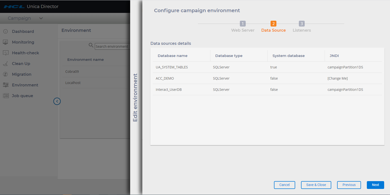

Data Sources
Data source details will be auto populated. Refer below screenshot:

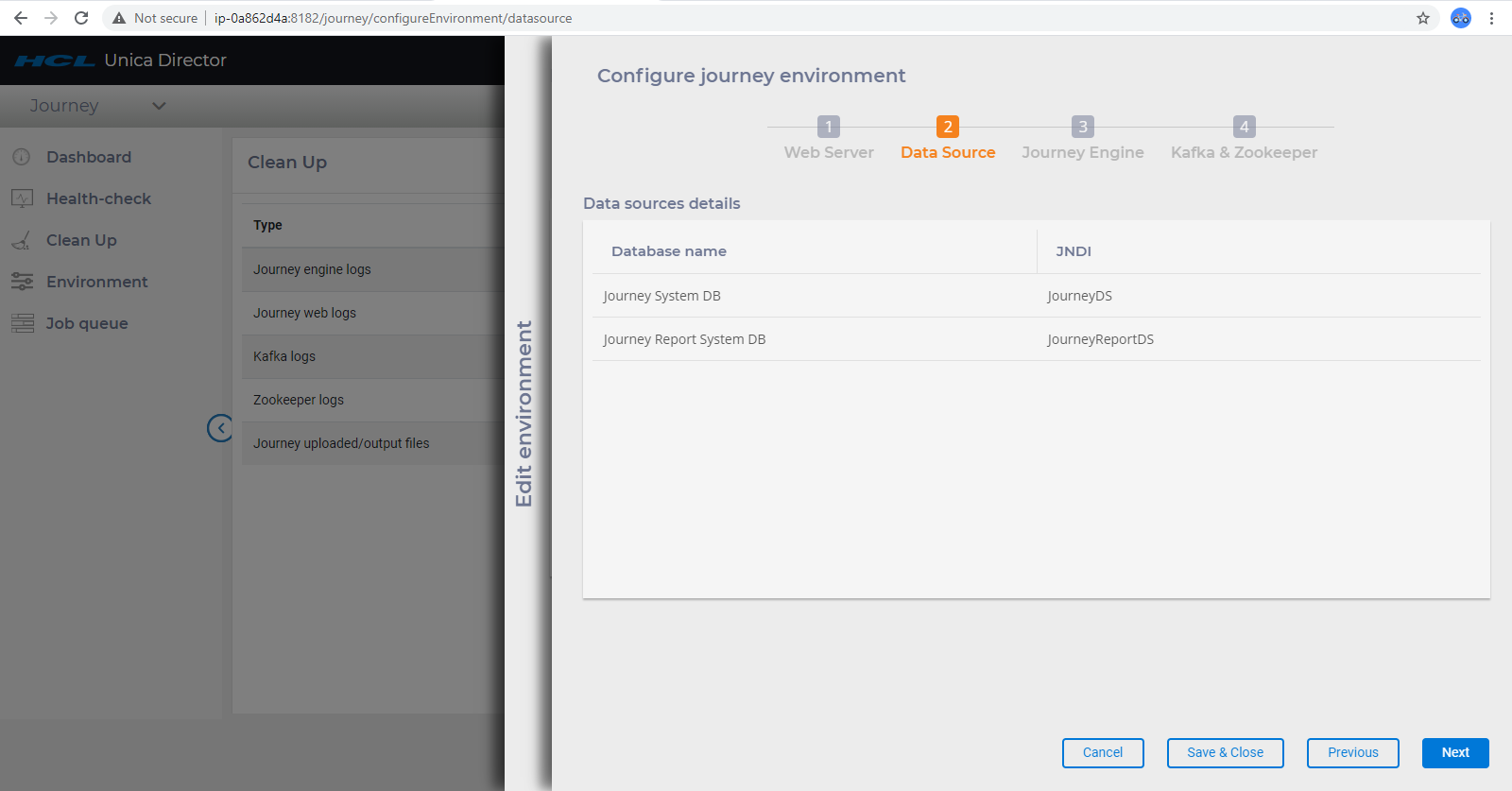

- Data Sources
For Journey the details of data sources- JNDI are pre-populated. User don’t need to add or update anything here. Below two data sources-JNDI automatically populated.
Database name JNDI Journey System DB JourneyDS Journey Report System DB JourneyReportDS - Journey Engine

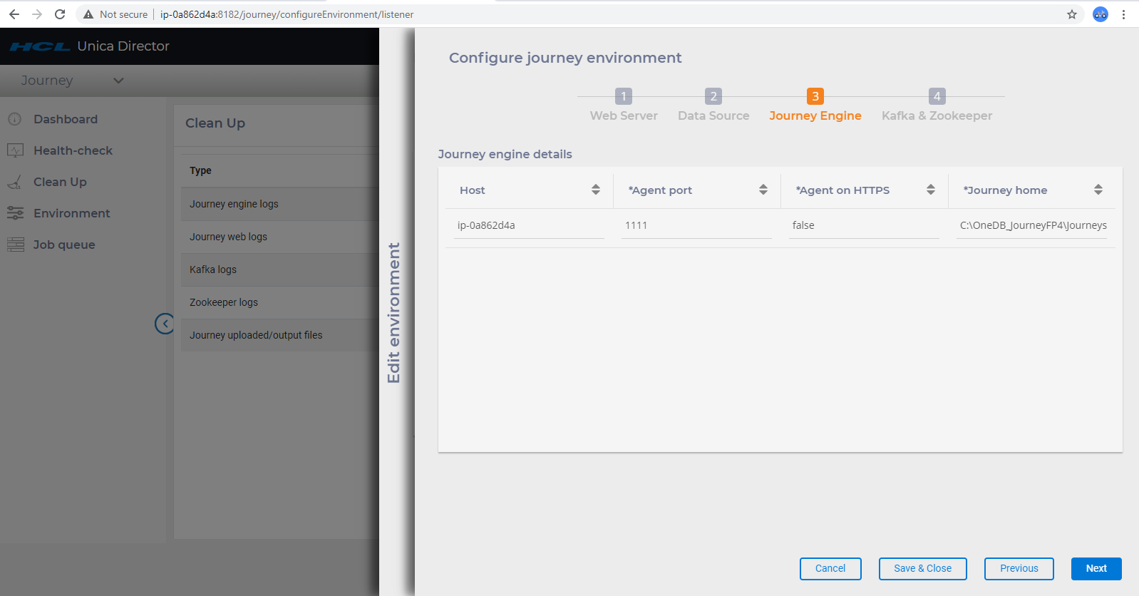

For Configuring Engine on Director:- Need IPof system where agent and engine are running.
- Need port of director agent.
- Need Engine Home, path where engine is installed.
- For Linux Env scripts folder should be in <JOURNEY_HOME>/Engine.
Engine can be stopped/started/Restarted from Director. Logs of Engine can be deleted /Downloaded from Director

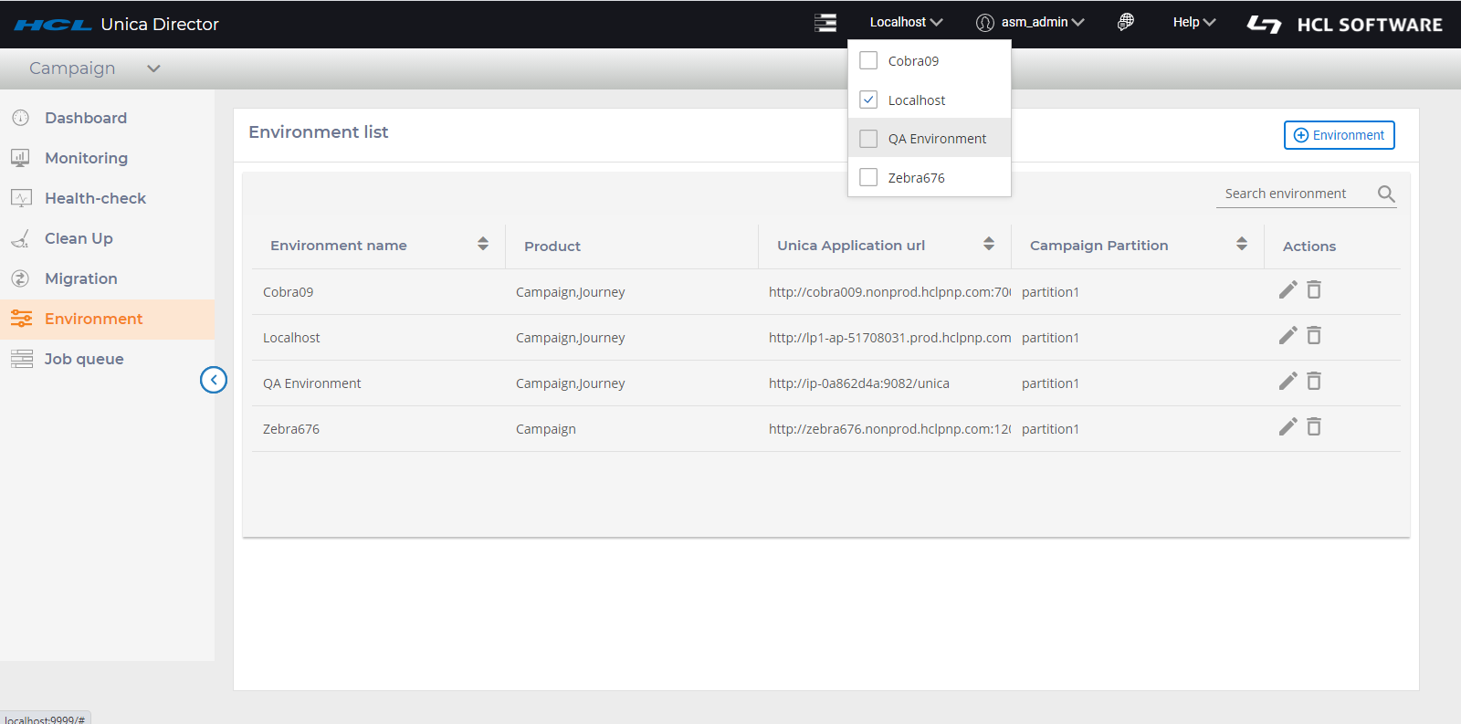

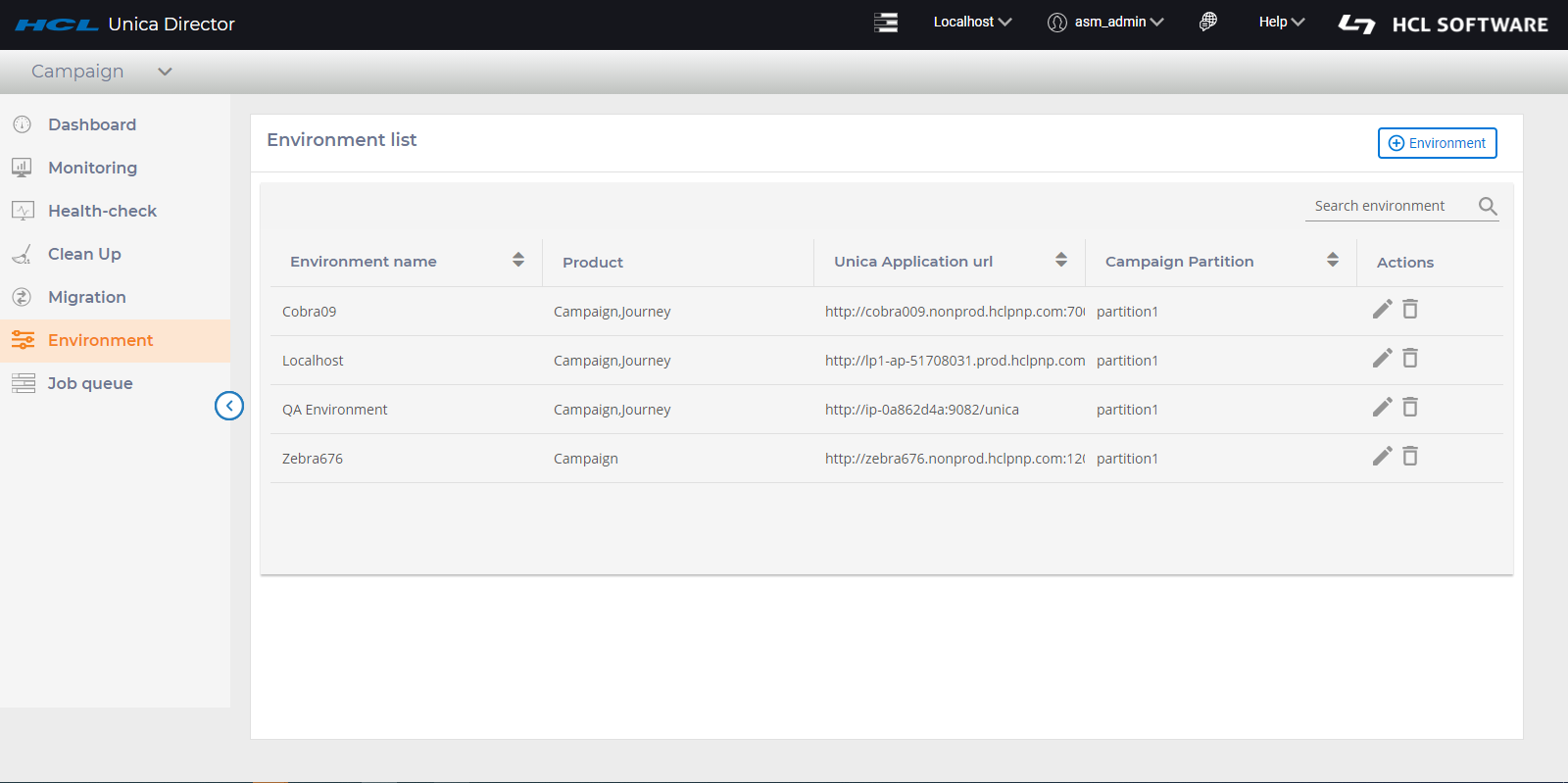

Modify Environments
You can modify an existing environment by clicking on the ‘edit’ icon (the pencil shape) under the Actions column of the environment you want to edit.
This will open the environment details page (as shown in the Add Environments section). After making your changes click on the Save button to ensure that your modifications have been saved.
You can delete an environment even if it is in use. Click on the ‘Delete’ icon (trash can’ under the Actions column of the environments list.
You should be very careful while deleting an environment as it might have a significant impact other users using the environment.
Switching to a different Environment
- Select the environment to work on from the top right corner.
- You will be prompted for the Marketing Platform login user ID and password.
Application
- Check the Web server status for application Campaign for the QA environment.
- Clean Journey engine logs for Journey application for the QA environment and so on.

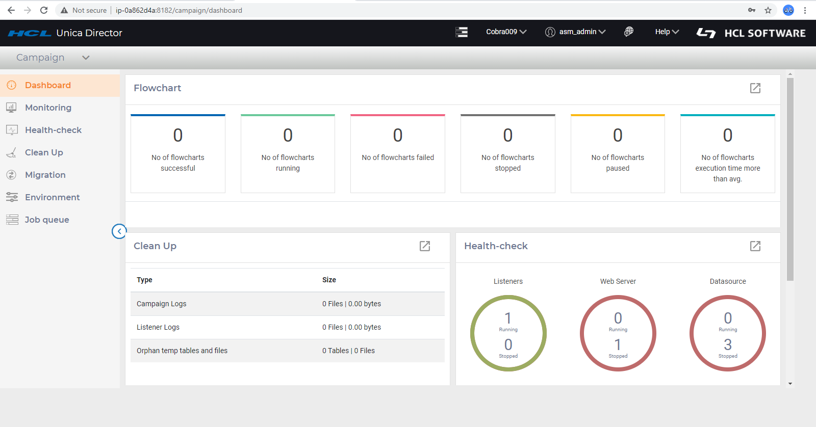

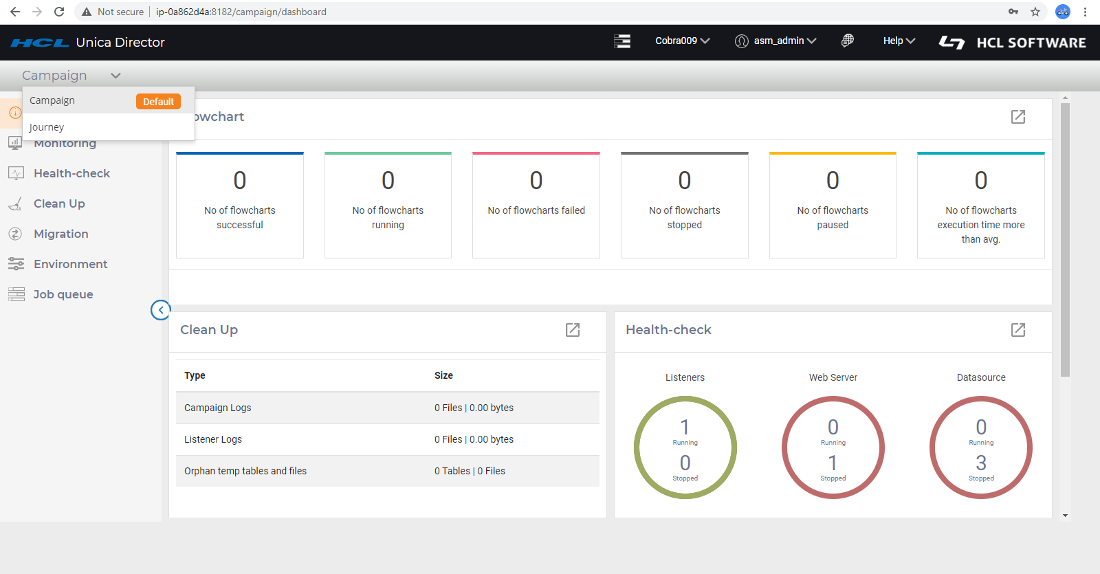

User must login to the environment to which they want to monitor and access various functionalities. Once logged in, user is presented with the Dashboard page of default application. For example. In Below screenshot, user is logged in to Cobra009 environment and the default application is Campaign.
The first view is the Dashboard view, hence Campaign dashboard.

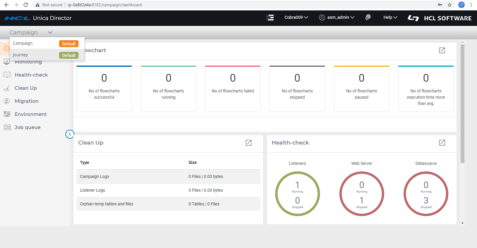

To view all the application that are configured in an environment, user can click on the dropdown as seen in below screenshot. The default application is Campaign as indicated by the orange tag next to Campaign.
All the links that appear on the left panel are part of campaign. So if user clicks on Health check, it would show up details of Campaign health check and if user clicks on Clean up, it would show up the Campaign clean up items. To switch to Journey application, user will have to click on Journey and the default dashboard page of Journey would be presented.

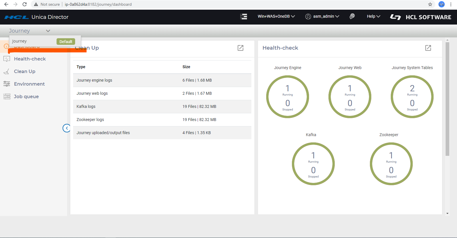

Changing the default view
- Click on the green tag default next to
application
- User will be prompted with below message
- On user confirmation, the default application will be changed.
- Next time when the user logs in, they will now be presented with the dashboard of Journey application.
