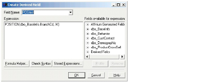

Examples
A ', within the value
of the column, dbo_BaseInfo.BranchCd, and assigning
the returned value to a derived filed POStest.

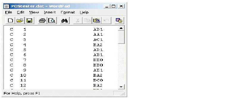

The following example shows a few rows from the table
with the values from dbo_BaseInfo.BranchCd and POStest shown
side-by-side.
