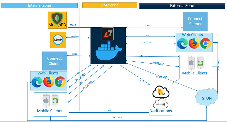

Small Sametime Premium deployment on Docker
If your environment includes a DMZ, you can place Sametime in the DMZ and open the
required ports.
In this example, clients can connect to Sametime from both inside the internal
network as well as from the Internet. Browser clients and Mobile clients connect to
Sametime using HTTPS port 443, and UDP port 10,000. These clients also connect
directly to STUN on the Internet (or internally if installed as an optional
configuration) on port 19302 UDP. Mobile clients must connect to the push
notification services on the Internet in order to receive chat notifications in the
client. Sametime desktop clients (those which are installed rich clients -Sametime
Connect and Sametime embedded) are connecting on port 1533 TCP.
The following graphic shows a small HCL Sametime Premium with internet access using
Docker.

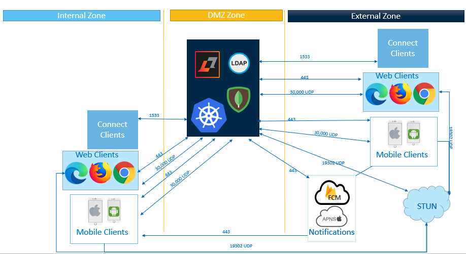

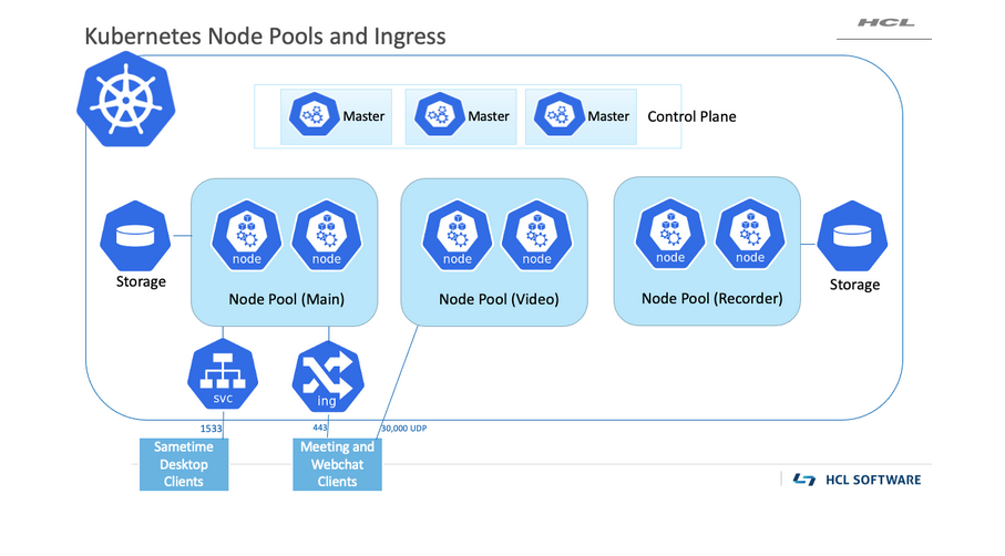

When you deploy Sametime in Kubernetes, the Kubernetes cluster requires three node
pools. Each node pool performs a different function. One node pool is dedicated to
video, a second one for recorder and a main node pool for all other Sametime pods.
The number of nodes in each node pool determines the capacity of the environment. An
ingress controller is used to front-end connections from users to the webchat and
meeting https services. Media streams are over UDP Port 30,000 and connect directly
to the video node pool. Sametime desktop clients connect to a Sametime Mux
Kubernetes service (svc) on port 1533 (TCP).
The following graphic shows Kubernetes node pools and ingress.
Connectivity for end users is very similar to the Docker deployment. The difference
is UDP port 30,000 is used for media streams instead of port 10,000. There may be
multiple nodes in the video node pool, and clients must be able to reach each one on
port 30,000.
The following graphic show an overview of connectivity in a Kubernetes
deployment.
