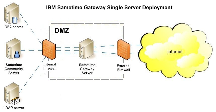

Topologies for a standalone server
A standalone Sametime Gateway Server has its own administrative console. Standalone servers do not require a SIP or XMPP proxy server. In the following configuration, the Sametime Gateway Server is deployed outside the internal firewall in the DMZ, while DB2® and LDAP servers are behind the firewall.

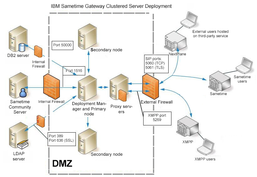

Topologies for a managed group of servers
Each of the following deployments consists of a cluster of servers that work together in a cell to provide high availability and failover. There is one administrative console to manage all servers. The following cluster deployments are considered:- Scenario: Two-computer installation of a cell of Sametime Gateway Servers
- Computer 1: DB2, Deployment Manager, primary node
- Computer 2: secondary node, proxy servers
- Scenario: Three-computer installation of a cell of Sametime Gateway Servers
- Computer 1: DB2
- Computer 2: Deployment Manager, primary node
- Computer 3: secondary node, proxy servers
- Scenario: Four-computer installation of a cell of Sametime Gateway Servers
- Computer 1: DB2
- Computer 4: proxy servers
- Scenario: Five-computer installation of a cell of Sametime Gateway Servers
- Computer 1: DB2
- Computer 4: secondary node
- Computer 5: proxy servers

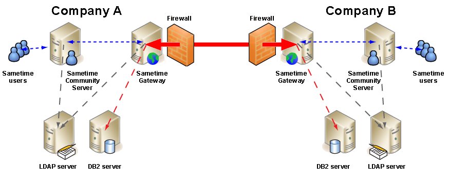

Typical deployment when connecting to instant messaging communities
Sametime Gateway Server allows selected individuals in your company to send instant messages to users on one or more public networks, giving your users immediate access to millions of users worldwide. When you connect to other Sametime companies, you can connect business users of different companies. This deployment is very useful in case of acquisitions when IT infrastructure is still separate, when you want to interconnect vendors over the Internet. Connections are made secure by using an SSL certificate exchange..

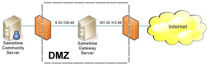

The following graphic shows how you can simulate a NAT (Network Address Translator) by using two Network Interface Cards (NICs), one for an internal IP address and the other for an external IP address.

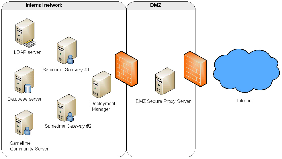

The following graphic shows how Sametime Gateway security can be enhanced using the IBM WebSphere DMZ Proxy Server. Using this component, a firewall can be inserted between the SIP proxy (hosted on the DMZ Secure Proxy Server) and the Sametime Gateway Servers. The following two deployments are supported:
The following graphic shows a "single DMZ" configuration, the DMZ Secure Proxy Server is deployed in the DMZ while the rest of the Sametime servers, including Sametime Gateway Server, are deployed on the corporate intranet. All requests from external clients are routed through the DMZ Secure Proxy Server.

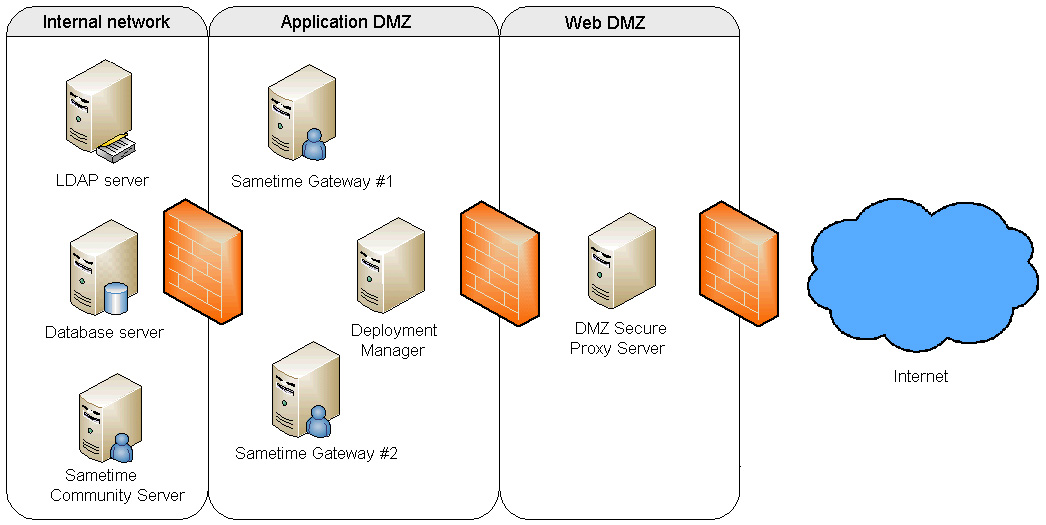

In the "dual DMZ" configuration, the DMZ Secure Proxy Server is deployed in the outermost "Web" DMZ, the Sametime Gateway Servers are deployed in an inner, "Application" DMZ, and the rest of the Sametime servers are deployed on the corporate intranet.
