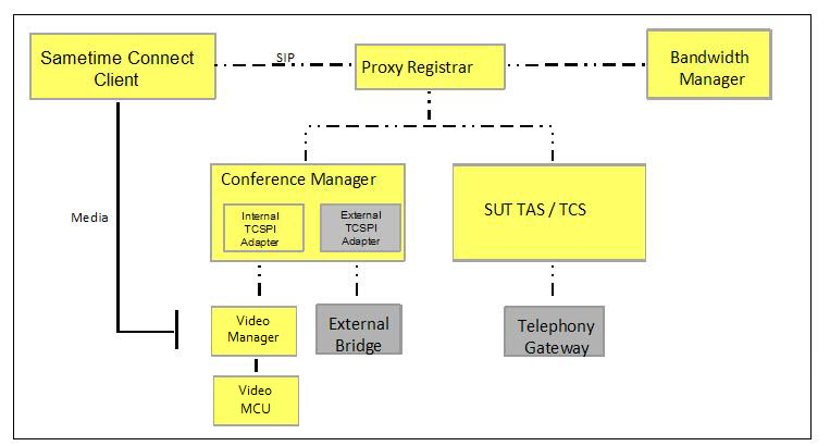

The graphic that follows show how the Bandwidth Manager communicates directly with the Sametime SIP Proxy/Registrar, using it to relay bandwidth constraints to clients using audio and video features. If the deployment additionally includes Sametime Unified Telephony, that application shares the same SIP Proxy/Registrar to ensure that it can access bandwidth constraints as well.
