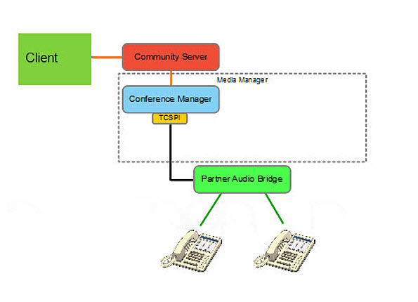

The following graphic shows how you can deploy the Media Manager, along with a TCSPI adapter that you get from the bridge vendor. This allows you to control your audio conferencing experience from your Sametime client. You can join calls, dial out, display dial-in numbers and pass codes, monitor participants, and so on. If the bridge supports SIP, you'll be able to connect using your Sametime client.

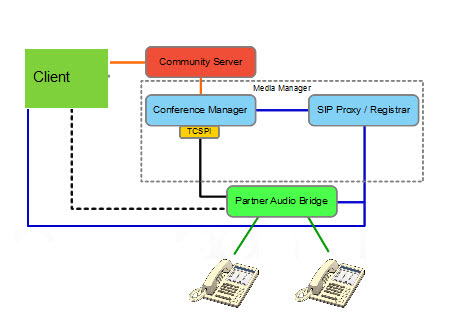

The following graphic shows a partner audio bridge that supports
SIP, connected to the Sametime SIP
Proxy/Registrar.
