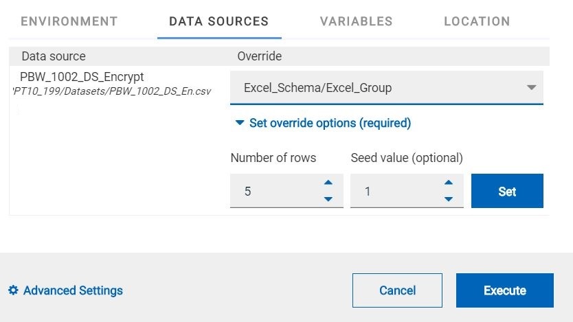

Click the DATA SOURCES tab and perform the following
sub-steps:
- Click Set, and then Execute.
