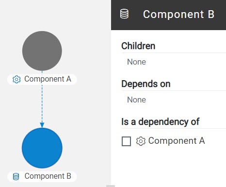

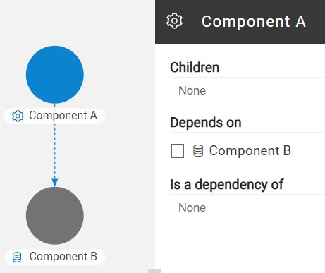

Component relationships
You can create multiple components to depict the different resources in the system or application under test. You can create a component as a child component of a parent component. You can also create multiple components as children components of the same parent component.
You can define the relationship between components if one component depends on another or if a component has a dependency of another component. The Depends on or Is a dependency of relationship depends on the component that you select in the system model after you define the relation.
For example, if you define Component A to depends on Component B, then the relationship is displayed with a line arrow from Component A to Component B, and the arrow points to Component B.
