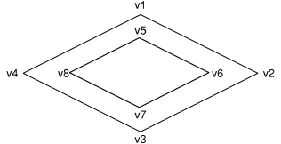

A sample polygon instance
The following figure shows a polygon with one hole and
a total of eight vertices.Figure 1: A sample polygon
For this example, NumParts equals 2 and NumPoints equals
10. Note that the order of the points for the doughnut (hole) polygon
is reversed below.
