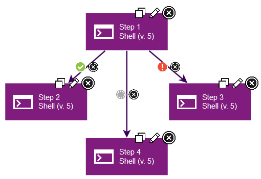

A step can have multiple connections with different conditional
flags. For example, the following figure shows a step with three connections:
- The connection to step 2 has a
successflag. Step 2 runs if the first step finishes. - The connection to step 3 has a
failureflag. Step 3 runs if the first step fails. - The connection to step 4 has a
bothflag. Step 4 runs regardless of whether step 1 finishes or fails.
